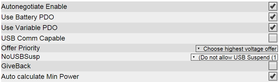

I am trying to understand how autonegiation works. Are there any documents that describes autonegotiation in details? How do TPS65982 use values from TxSinkCap(0x33), RxSourceCap(0x30) and AutonegotiateSink(0x37) registers.
In example,
I have a PowerSource device that declares 5V/3A, 9V/3A, 12V/3A, 15V/3A and 20V/3.0A power capabilities, both PDO are Fixed Type. It is connected to Sink (based on TPS65982). Sink declares 3 PDO in the TxSinkCaps: Fixed 5V/0.5A, Battery 1V/20V/5W and Variable 1V/20V/3A. AutonegotiateSink (0x37) register configured as follow:
In this case TPS65982 selects for contract PDO number five (20V/3.0A), but requests 1.5A Max/1.5A Operative currents. How this 1.5A is calculated? Why Battery Sink PDO is selected? Why not Variable Sink PDO?

  • Hi Alexander,
    You are correct, the sink is requesting 5V@1.5A which I assume is due to the 'Ask for max' bit not being checked in the sink capabilities register. In this case the 82-sink will request only its minimum operating current and depending on the autonegotiate register the sink will choose the source's highest current, voltage or power PDO.
    Let me know if you have any more questions.

  • Hi Alexander,
    - the fixed sink PDO is a match if the voltage matches the source PDO and is less current than the source PDO
    - the variable sink PDO is a match if the upper limit of the sink PDO is higher than the source PDO
    and the lower limit of the sink PDO is below the source PDO (so the sink PDO expands a greater range than the source PDO)
    note: variable source PDO is not applicable.
    -you will only achieve a capabilites mismatch bit if you mismatch on the current. If you mismatch on voltage then this voltage mismatched PDO will not be selected. this is because all sources need to be able to source 5V and all sinks need to sink 5V
    - typically the first thing to do is match the highest voltage you can match.Then if the sink wants say 3A and the source can provide only 1.5A then the request will be 'highest_matched_voltage'@1.5A with the capabilities mismatch checked. (which basically means Ill take what you give me but ill check this bit becuase im not happy and its not enough)

    For the 82, battery PDOs are similar to variable PDOs but they operate under power requirements. The preferred PDO is chosen by 0x37 the autonegotiate regsiter and will tell you which one of the source caps the sink will request. You are able to mix and match PDO types.
