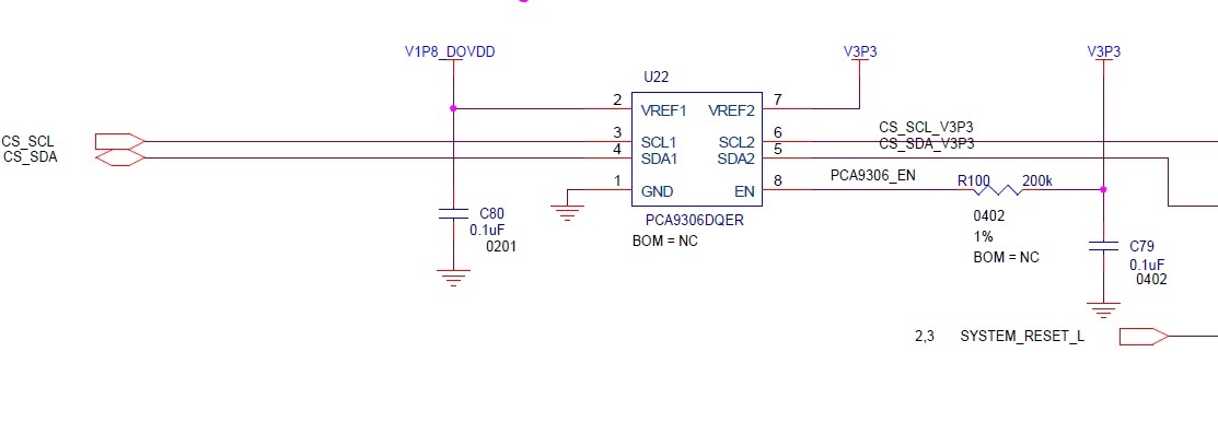

PCA9306: Connected VREF2 to +3.3V instead of to pin 8
Part Number: PCA9306

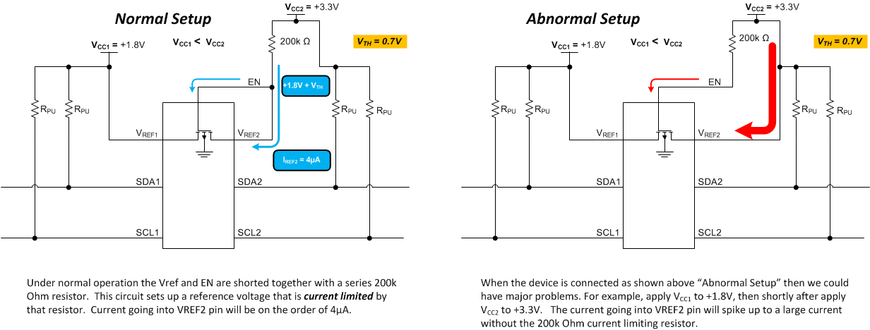

I messed up and instead of connecting VREF2 to pin 8 of the chip (the Enable pin, which then connects to +3.3V through a 200k Ohm resistor), I connected it directly to +3.3V.
VREF1 is +1.8V and I'm seeing it's Voltage fluctuate at a very low frequency between about +2.2V and +1.8V.
Could this be caused by my screw-up?
