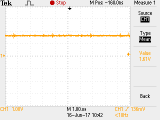

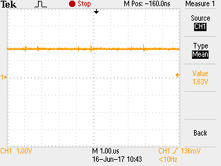

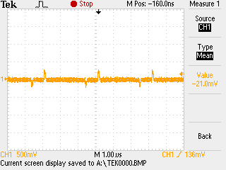

Hi to all!
I have some troubles with starting of LMH0356 27MHz clock generator.
I already checked circuit, 39pF capacitors, tried two different crystals - 7B-27.000MBBK-T, TXC and other in HC-49/S case.
In all attempts i have the same oscillograms:
Between XTAL IN and XTAL OUT
Beetwen GND and XTAL IN, XTAL OUT
Is there any ideas what else may be done to start oscillation?
