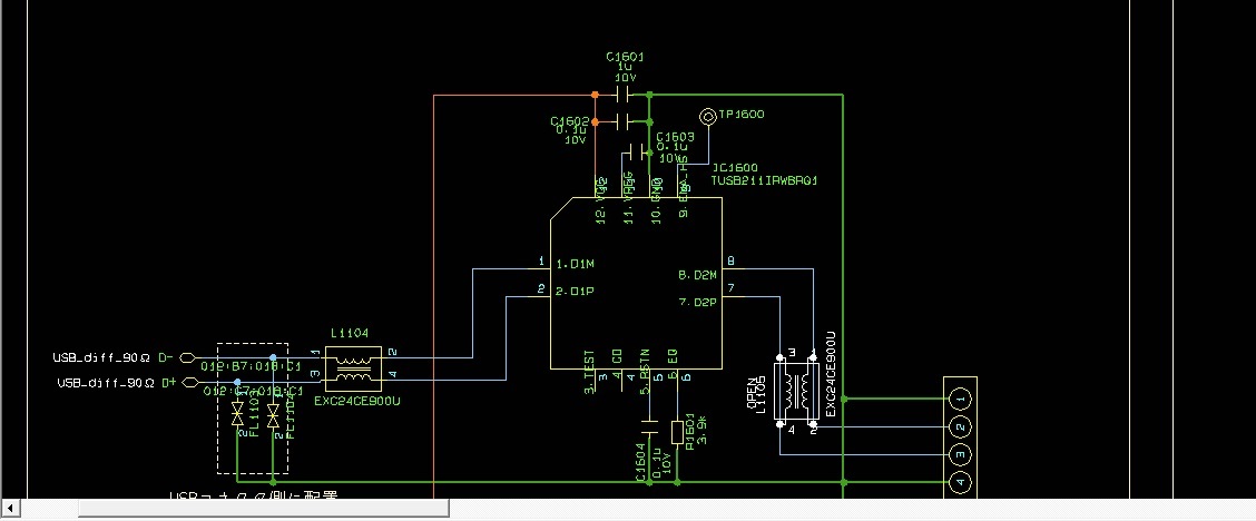

Dear Sir/Madam,
Thank you for your support always.
We are using TUSB211IRWBRQ1 Signal Conditioner IC in our design , but this does not give out 1.8V at VREG Pin # 11, in High Speed Mode(special High speed program running on Host)
When we check the Eyepatterns ,  the Eyepattern remains the same  in both PCBs i.e.with TUSB211IRWBRQ1 mounted in the PCB#1 and also the PCB#2 which does not have TUSB211IRWBRQ1.
Note that , the ports 1-8 and 2-7 are already shorted as per the datasheet requirement.
The result of Eyepattern check is always fails.
Please confirm:
1.How to check this gauranteed operation of the device TUSB211IRWBRQ1 in the PCB.
2.How to fix the issue with VREG volatge level , it is always zero in our case , inspite of  VCC =3.3V.
Schematics is also attached for your reference.
Kindly check and confirm and please support.
Sanjay
  • Hi Sanjay,
    please confirm that your tests follow the procedure described in the datasheet of TUSB211 page 9.
    1. Power on the device
    2. Connect the test fixture
    3. Enable the Host transmit TEST_PACKET
    4. Execute scope compliance software
    to ensure that TUSB211 gets activated. Please also check VREG and ENA_HS when plugging in USB HS device and confirm activation.
    VREG only activates when TUSB211 detects HS USB signal to save power.
    Best regards
    Cevin
