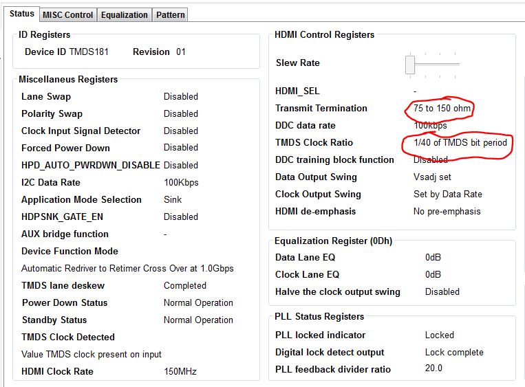

We're under co-work with customer about the DP159 performance , we used DP159RSBEVM  (source: HDMI 2.0 input , sink: HDMI 2.0 output) as retimer for HDMI 2.0 to HDMI 2.0 external monitor application.
But it since like the output only workable with HDMI 1.4 or HDMI 2.0 @ 30KHz.
Could we make a fine tune to adjust the EVM resistance or component to output HDMI 2.0 @ 60KHz?  (BTW, TMDS181 EVM is workable without fine tune)
thanks again.

  • Hi Kay,
    Which input is being used: DP or HDMI?  Can you confirm if there is a HDMI 2.0 resolution option available with the DP159RSBEVM is used?  This would indicate a DP++ driver issue, assuming you are using the DP input.

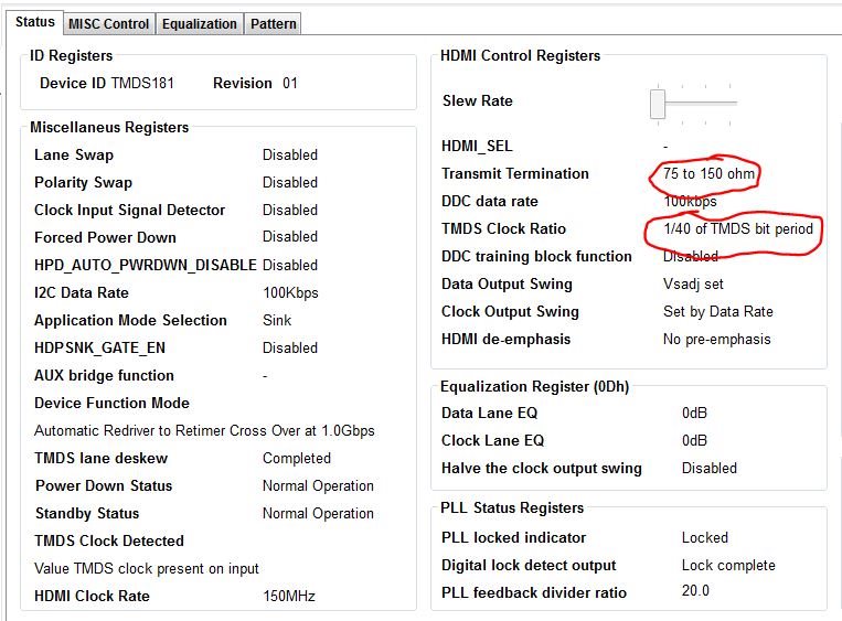

    The tx_term_ctl is only accessible in the DP159RGZ package, so the tx_term_ctl setting should not be the issue here.
