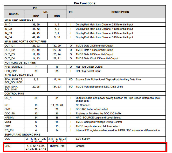

My customer is considering to use SN75DP139RGZ..
Can the thermal pad be connected to GND?
Connection of thermal pad of RGZ package is not mentioned on the datasheet.
(However RSB backage of thermal pad is mentioned as follows.
