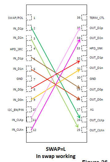

Hi Team,
We would like to know the behavior at SWAP/POL=Low.
I understand that the each signal paths are as follows so if SWAP/POL=Low, TMDS181 don’t swap polarity(P and N).
Is my understanding correct?
[For example]
-From IN_D2p(2pin) to OUT_CLKp(26pin)
-From IN_D2n(3pin) to OUT_CLKn(25pin)
