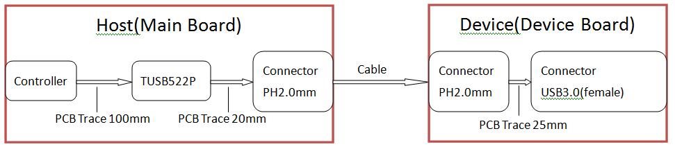

Cable:PH2.0 connector,USB3.0 Cable,1500mm

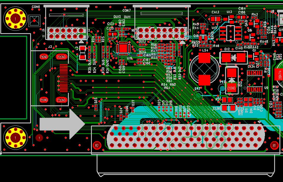

MB Board:
DB Broad:

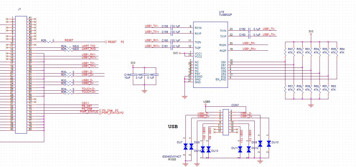

Question:EQ,DE,OS How to set?

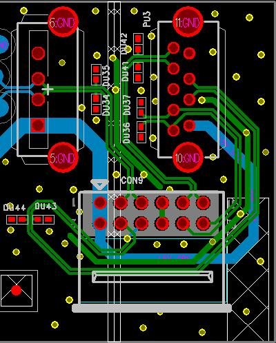

Now we changed the length of usb3.0 cable,it's 2000mm. The previous parameters can not be used,how to set the EQ,DE,OS?
And There is a question to ask, we debuged a parameter, DE-H,EQ-H,OS-H,there is no problem when read U disk data , but when white U disk data, A transmission error always occurs, why?

Hello Walker,
Please try to increase the OS on both TUSB522, that should be enough.

Hi Walker,
I understand the situation. In order to provide a precise solution, I need to have more information. It seems that the re-driver is working bot the configuration is not the best one for the channel, so the Host is not passing the polling step from the enumeration. Do you have a way to get an eye diagram from the port, or at least a log from a USB analyzer?
