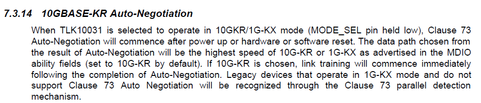

We understand that the default setting of TLK10031 when MODE_SEL pin held low is 10GKR/1G-KX mode.
If we use 10G-KR and don’t use detail setting, can TLK10031 operate even if we don’t set the register by MDC and MDIO?
Kanemaru
  • Hi Kanemaru,
    The device is configured in 10GBASE-KR by default. Hence if you don't configure the device through MDIO, you jus need to perform a hardware reset. On the other hand, I suggest configure it through MDIO since the TLK is a complex device and several registers would need to be adjusted (equalization, data switch, etc.) according every system (AC losses, length of traces, among others).

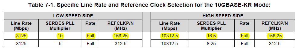

    Our customer would like to use “REFCLK 156.25MHz” for “10GBASE-KR Mode”.
    According to the datasheet, SERDES PLL Multiplier of High speed side default setting is 20x and Low speed side default setting is 10x.
    Therefore, I understand that TLK10031 can’t communicate “10GBASE-KR Mode” if they use “REFCLK 156.25MHz” at the default .
    Because, they have to set the following conditions.
    Is my understanding correct?
    Kanemaru
  • Hi Kanemaru,
    Your assumption is correct. Customer needs to set the SERDES PLL Multiplier (HS side) to 16.5 since the default value is 20. This is done through the register 0x1E.0002 bits [3:0].
    Therefore, they change “HS_PLL_MULT [3:0]” from “1101(default)” to “1100” and don’t change the other resisters(so the other resisters are default).
    Is there the other register that they have to change?
    So, could you please let us know if you have the recommended setting for this use case?

    If the customer is going to use 10GBASE-KR mode, they just need to change the HS_PLL_MULT[3:0] to '1100' (x16.5), in this case the device is going to perform Auto-Negotiation and Link Training, if the these featured are no needed please disable them.

  • Kanemaru,
    If the device is set by default (except HS_PLL_MULT), LT and AN will run after power-on. If customer is planning to interface with SFP+ optical modules, they need to disable both features, if not, default values is OK.
    Luis
