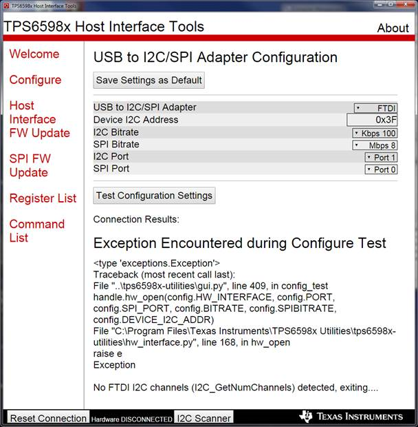

I am working with a customer who is having trouble establishing a connection with the FTDI device from the EVM.
Below are a few questions already asked:
- Is the barrel jack plugged into the 81? If not, there will be no I2C or SPI communication to the device.
Yes, I have 20V and the LED comes on
- Are you able to read anything on the I2C scanner with the Utilities GUI?
Nothing. It seems to be acting like it doesn’t even see the FTDI at all
- Can you view the FTDI on your devices in windows?
I have 4 virtual COM ports that show up in the device manger (COM67-70)
He also mentioned that he has already tried installing on a different PC but has gotten the same result with the same error..
Please let me know if there are other things we can do to help solve this issue.

  • Hi Jerry,
    Thank you for your post. We realize this is a common issue due to the way FTDI and different systems interact.
    I would recommend first uninstall the Host Interface Tool. When you reinstall the tool ensure that you 'Uninstall all previous versions of FTDI' and install the FTDI drive that comes with the tool. We recommend using FTDI v2.08 (the latest is 2.12). This version comes with the tool and is found to be the most stable version. When you don't uninstall other versions, your system will use the latest one (whichever one that may be).

  • Hi Jaime,
    I have a question about the same board and using the host utility GUI.
    It works on Jerry's laptop showing the mode register as APP, but on mine it says that the mode register reads BOOT.
    The I2C addresses shown after scanning are also different. Jerry's shows 0x0 and 0x3f. Mine shows 0x3f and 0x6b.
    If you could provide some insight as to what might be incorrect, that would be much appreciated.
    Thanks in advance!
    Harrison
  • Hi Harrison,
    This is most likely not related to a laptop/FTDI driver issue. Can you confirm that you are following these steps when you try to reading the registers?
    1. Plug in the barrel jack, first.
    2. Plug in the Micro-B USB (for FTDI connection).
    Sometimes, when the Micro-B is plugged into before the 81 device gets power, the FTDI will hold the SPI lines up. When this happens the 81 will will be stuck in the boot mode.
    If you have followed these steps and see the same results, let me know.
    Thank you,
    Jaime
  • Thanks Jamie, plugging in the micro-b connector after the power made it work.
