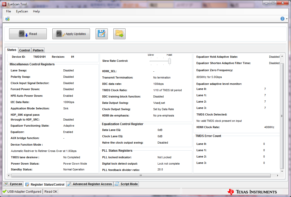

When we test TMDS181EVM with Quantumdata 780E
We need to re-click "apply updates" then quantumdata can display out normally (all of register is default ,just only re-click "apply updates")
May I know your suggest??

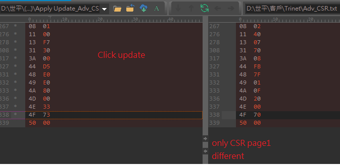

  • dear Moises
    check the register again
    Only CSR page1 have different ,below have attached file
    Register.rar
  • Hi Kai,
    The default register still doesn't look like default state.
    Is this issue happening with other displays?
    Could you check HPD_SNK is low when there is no display connected?
    If instead of doing "Apply Updates" you toggle the register 0x09[3] in the advanced register access, does it work?
    I see you didn't add register 0x00 from page 1, is it the same for both scenarios? what is the value there?

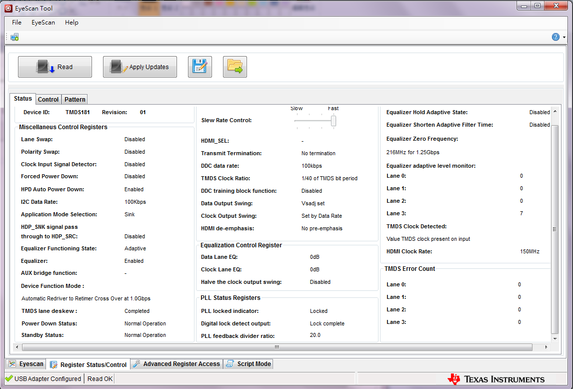

  • Dear Moises
    I will ask our customer to check video generator's register value
    But could you check the TMDS181 connect to Quantumdata's result first ?
    1. below is default value without any cable on EVM
    2. Below is connect input and output cable on TMDS181EVM and before click "apply update" => no display output
    3. Below is connect input and output cable on TMDS181EVM and After click "apply update" => display normally
