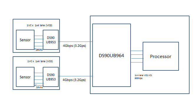

Hi
We are urgently trying to set up a datapath scheme as per the attached ie 2x 953 going into 1x 964 , with 1x4 lane MIPI and 1x VC from each camera and 2x VCs going from the 946.
We are having issues setting this up - configuration attached.

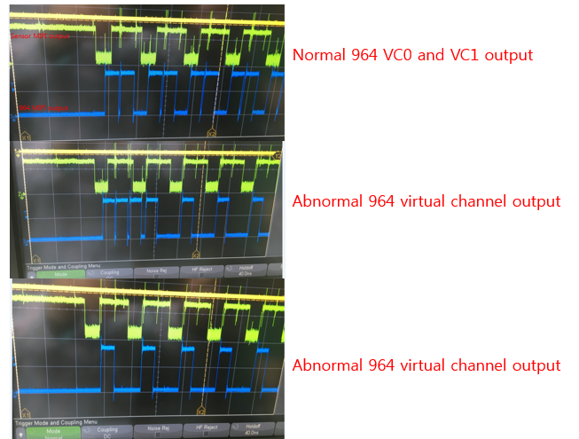

Both  sensors can feed their 1x VC on the  MIPI 4 lanes streams  to 964 via each 953 and 964 can output MIPI 4 lanes to the "Processor" via VC0 and VC1.
But our team found that the 964 virtual channel output is sometimes abnormal on OVT side like below pictures attached. We assume that there is some configuration error but we are not sure what steps to take next to debug it.
Can you make a suggestion as to how we debug it  - does the configuration attached look right?
many thanks
David
