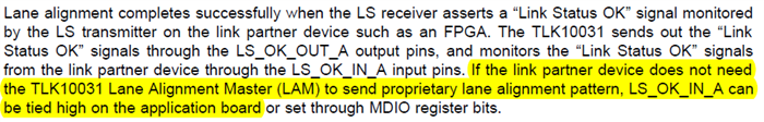

Hi Luis-san,
I understand that if the link partner device does not need the TLK10031 Lane Alignment Master (LAM) to send proprietary lane alignment pattern, LS_OK_IN_A can be tied high on the application board.
Then, Does LS_OK_IN_A pin need the pull-up resistor?
If yes, could you please let us know if you have the recommended value?
