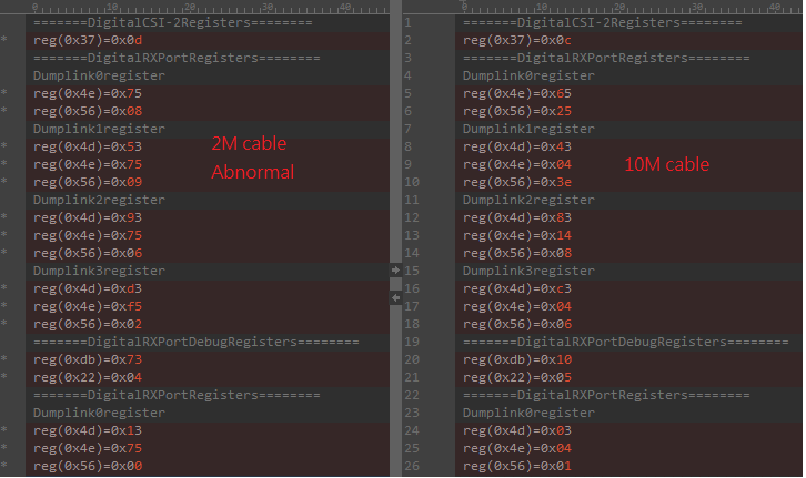

  • dear Junqiang
    1. Register compare as below
    2. Register 0x22 / 0x37 / 0x4D / 0x4E / 0x56 / 0xDB is different ,but all of register are read only

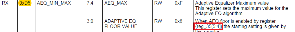

    2. 0xD5 bit 3:0 have description reg_35[5:4] ,but I can't find this register and don't understand what means Adaptive EQ floor value
    3.0xD2 in our setting is 84 ,so bit2 is 1 ,May I know what's different between 1 and 0 ?? due to default value is 0
    For the 2m cable application, please use default setting for AEQ. the AEQ_FLOOR is used for long cable application. So you don't need set the AEQ_FLOOR for 2m application.
    please see d/s description on AEQ's register for detailed message. thanks.

  • Dear Junqiang
    When I change 0xD2 register value from 0x84 to 0x80
    The display output still have blink issue and there are more different register value between 2M cable and 10M cable
    do you have any suggestion
    Different

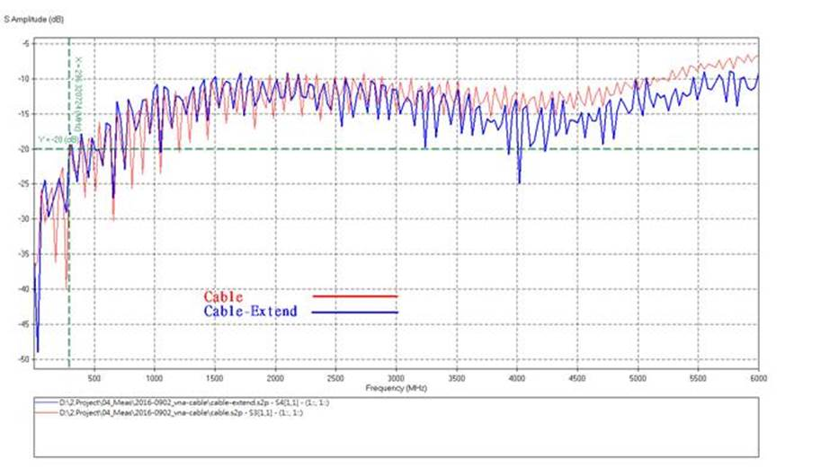

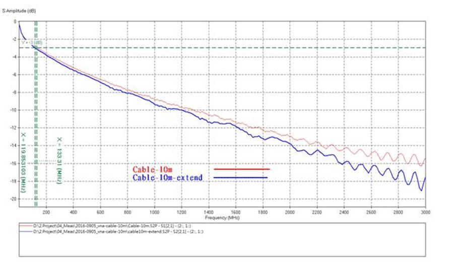

  • Dear Sir
    Below is S21/S12 parameters test result for 2M and 10M cable
    Cable Vendor is Amphenol's Fakra cable
    S21 for 2M
    S21 for 10M
    S11 for 2M
    S11 for 10M

    From the 2m and 10m cable comparison, the return loss of 10m cable is better. From your test result, it seems the register of 0xD3 is NOT correct when working at 2m cable, the value of register 0xD3 is 0x37, while for 10m cable, the 0xD3 = 0x27.
    so please check the power-on sequence firstly to secure UB964 can be adaptive the input data after power-on. besides, you can monitor the LOCK status, and cross-check by manually configuring the EQ value for UB964 under 2m cable test, to check whether it has flickering issue?
