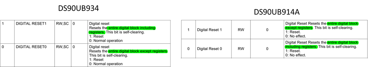

I would like you to confirm whether following infomation is correct or not.
* I compared register map b/w 914A and 934.
Then, I found following difference.
According to datasheet of 934, DIGITAL RESET 1 is for "Resets the entire digital block including register". However, on the other hand, according to datasheet of 914A,  DIGITAL RESET 1 is for "Resets the entire digital block except register".
It seems that meaning of bit 1 and bit 0 of "RESET" register are opposite 914A. I believe that these are compatiblity device, so I suspect one of above info is incorrect.
Could you please confirm this ?
