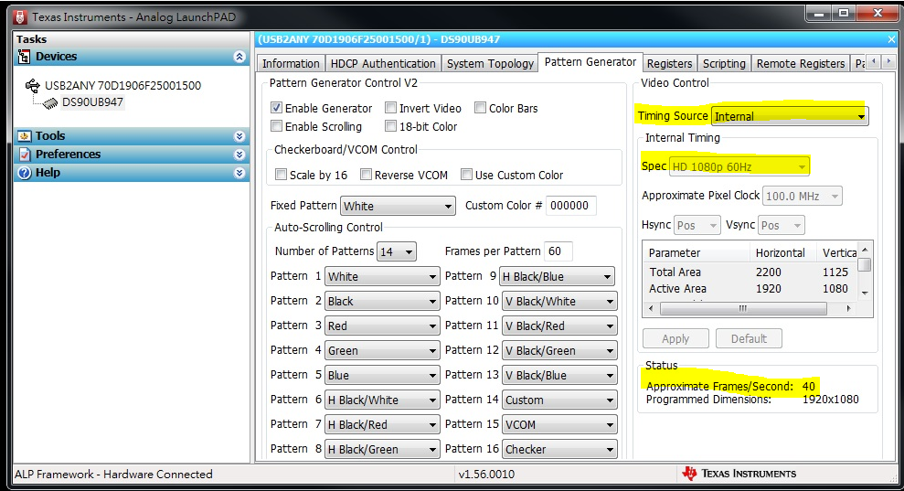

Another question of 947 and 948,
My customer choose the internal timing source and spec HD 1080p 60 Hz to generate the test pattern to panel.
But why the status shows that it only has 40 frame/Second? Please see below figure.
We try to change the timing source to external source, then the status shows 60 frame/Second normally.
Therefore, could you help to provide the spec of internal clock to us?
  • Hi Jim,
    1. Can you check only D_GPI1 has sudden jump here? how about D_GPIO0/2/3? whether UB948's lock pin has toggle here?  as the display has flicking, it seems the UB948 receives bit error, which also could make D_GPIO1 data output error. also, how about the D_GPIO1 abnormal output pulse width?
    2. . can you check and adjust the internal pixel freq., and the format settings (total area, active area parameter) to match the 1920x1080@60fps timing request.

  • Hi Steven,
    We met another issue recently.
    My customer used Analog LaunchPAD to generate the test pattern from UB947 to UB948.
    It can work normally when using Solid pattern (all white or all black or all red). And LOCK pin and the panel are stable.
    But if they use color pattern (mix black/white or mix black/red), LOCK pin start to toggling and the panel is flicking.
    The setting as below.
    Timing Source : Internal w/Ext. Clock.
    PCLK: About 148.5 MHz.
    Spec : HD 1080p 60 Hz
    If Timing source is Internal, then the issue has not been seen.
    Please help to give us some suggestion and comments.
    Thank you.
  • Jim,
    it seems the PCLK under color bar test is too high. could you please help check the link channel quality? You also can reduce the PCLK freq. to try it again?
    best regards,
    Steven
