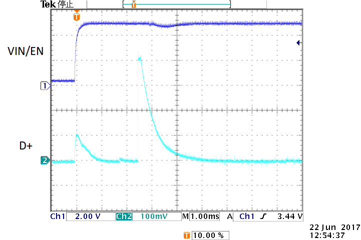

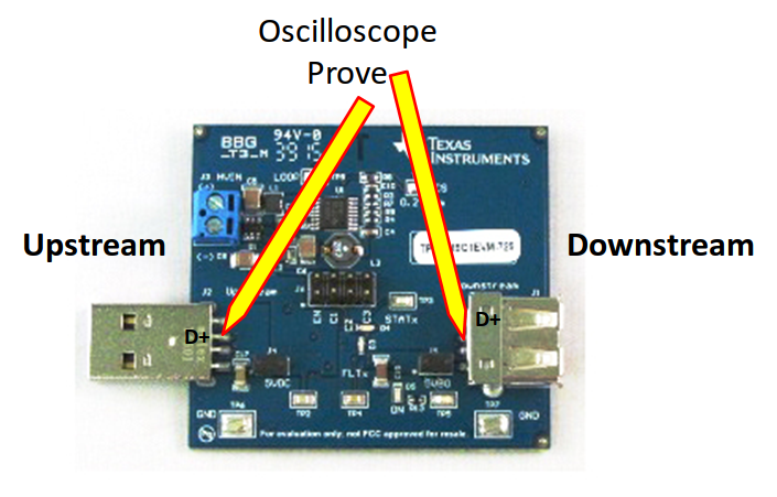

I have tested the TPS2549-Q1 EVM and found short glitch/pulse on D+ line when the EVM is attached/unattached to the PC.
Also, I have tried several different situations with my iPhone and USB Flash drive. The result shows that the glitch is slightly different on each USB load (i,e. Open, iPhone or USB Flash Drive).
Can you help me to figure out why this happen?
