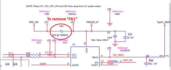

  • Hello Kanemaru-san,
        My bad, the internal Rd terminations are implemented by transistors, so you need to apply a voltage to the cc pins in order to test the dead battery mode in order to see the impedance. Also, the EVM must be modified for this testing. Please remove FB1, so the device will not have voltage on its VDD terminal, then connect one of the CC pins to a 56KOhm pull-up resistor to 5V and measure the voltage at the CC pin. Please post the measurements on both CC pins.
    Diego.

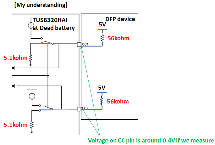

  • Hi Diego-san,
    Thank you for your response.
    I understand that we can use the dead battery mode(so UFP mode) when VDD isn’t applied if we remove FB1.
    Is my understanding correct?
    And, I have one more question.
    According to your comment, I understand it is OK, if the voltage of CC1 or CC2 pin is around 0.4V.
    Kanemaru
  • Kanemaru-san,
    Both assumptions are correct!. Please let me know your findings.
    Diego.
