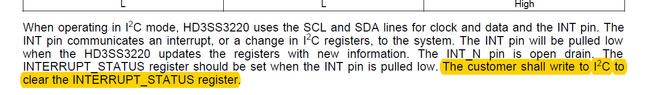

There are some descriptions in the datasheet about the Pin INT and register INTERRUPT_STATUS.
According to the datasheet, The INT pin will be pulled low when the chip updates the registers and the register INTERRUPT_STATUS will held high.

  • Hello Lacey,
    The customer must write a 1 to the Interrupt status bit in order to clear the interrupt and the INT pin, the pin will follow the status register automatically. So addressing your questions:
    1. - No, The customer must clear the INTERRUPT_STATUS bit via I2C.
    2.- Yes it can, just follow the datasheet section 7.5 for a detailed description.
    3.-The change on the INT pin is almost immediate
    Diego.

  • Lacey,
    The customer must write a '1' to the register, then the device will clear the interrupt and the register as well. So if the customer tries to read the register again it will contain a 0.

  • Hi Lacey,
       There is no need to write a 0 to the interrupt status bit. The standard and simple procedure to handle the interrupts is the following:
    1. An event occurs, the Interrupt status bit is set to 1 and the INT output is asserted (LOW).
    2. The MCU responds to the INT signal assertion and reads the status registers from the HD3SS3220 (0x08:0x0A).
    3. The MCU writes a 1 to the interrupt status bit in the HD3SS3220.
    4. The HD3SS3220 automatically clears the interrupt status bit and resets the INT output (High).
    Diego.
