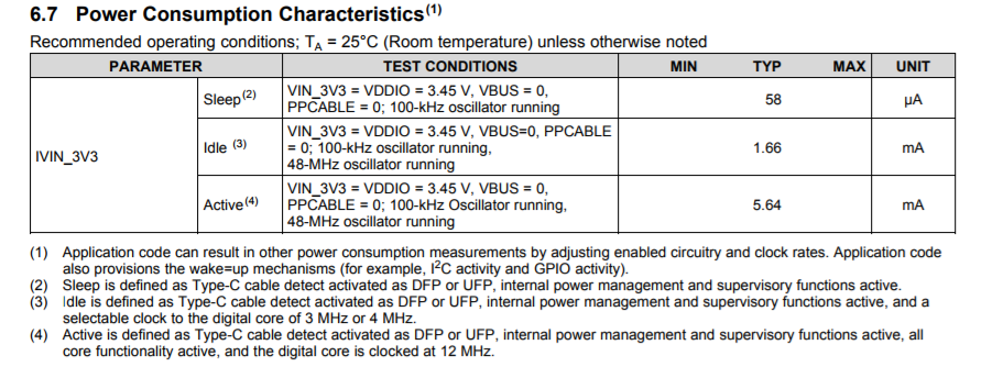

  • No load power consumption

    *Power consumption can be found in the datasheet under Section 6.7.

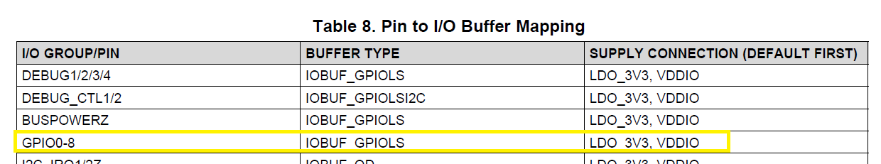

  • in continuation to my previous questions how are GPIO 0/1 interfaced and in what condition will these be pulled up to supply? as i see that these can be pulled up to LDO3V3 , is that correct?
    similarly for USB2P & USB2N
  • Hi Siddharth,
    GPIO0/1 can be configured in the Application Customization tool in the GPIO Event Map (Register 0x5c).
    It is dependent upon user's desired configuration whether the internal pull up/ down are enabled.
    As far as GPIO0/1 is concerned, it can be referenced in Table 8 of the TPS65982 datasheet that the GPO0/1 are connected to LDO_3V3.

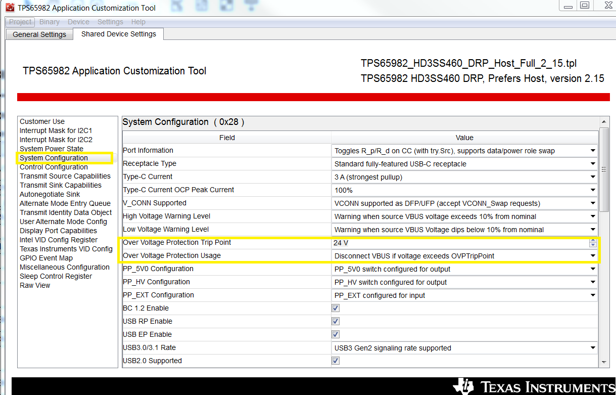

  • Hi Siddharth,
    The OVP threshold on VBUS is between 5V-24V(Section 6.6 in datasheet)  and is set in register 0x28 System Configuration by using the Application Customization tool.

  • thanks for the reply but i was requesting is procedure by which the gate of the internal FETs along the PPHV to VBUS path are being controlled in case of an over voltage. also i see a fast current limit along these paths ,how is that controlling these FETs?
