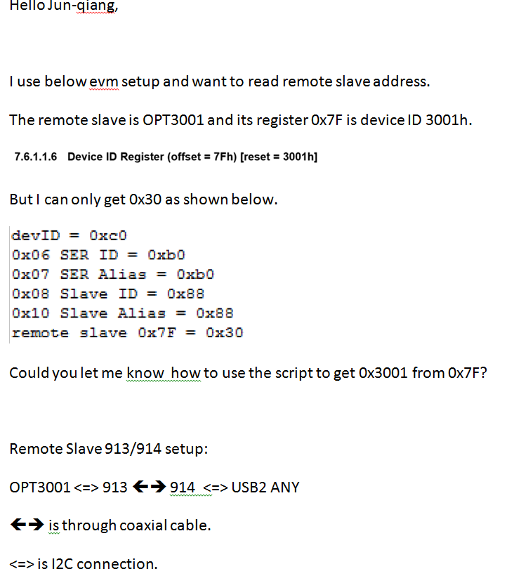

  • Hello Jun-qiang,
    I use 913 and 914 evm with coaxial cable and a I2C as remote salve connected at 913 side.
    I am able to read the remote slave. Thank you.
    But may I confirm with you that by using Script board.ReadI2C we can only read 2-byte?
    Ting

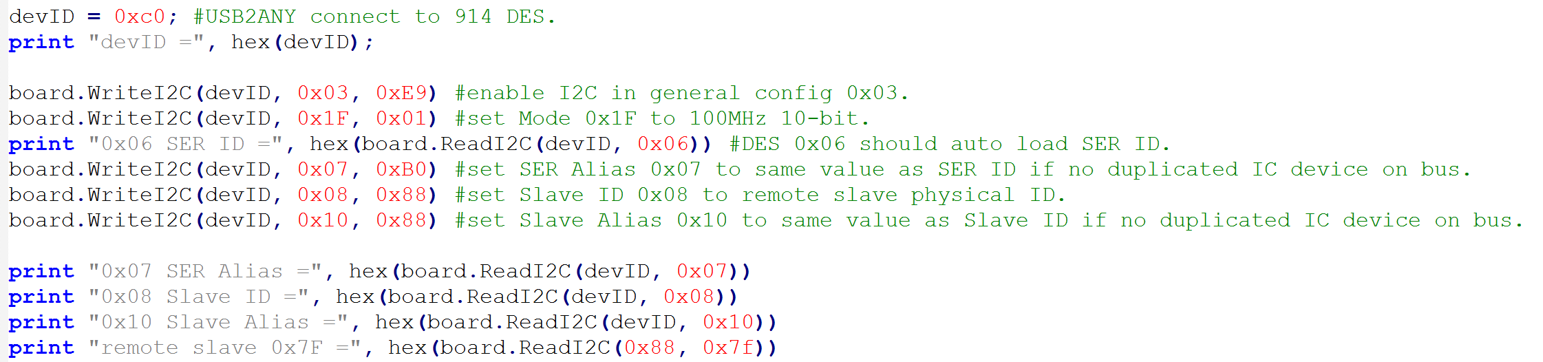

  • Below is the script I use to get 0x7F read out. Please change the filename extension to py.
    devID = 0xc0; #USB2ANY connect to 914 DES.
    print "devID =", hex(devID);
    board.WriteI2C(devID, 0x03, 0xE9) #enable I2C in general config 0x03.
    board.WriteI2C(devID, 0x1F, 0x01) #set Mode 0x1F to 100MHz 10-bit.
    print "0x06 SER ID =", hex(board.ReadI2C(devID, 0x06)) #DES 0x06 should auto load SER ID.
    board.WriteI2C(devID, 0x07, 0xB0) #set SER Alias 0x07 to same value as SER ID if no duplicated IC device on bus.
    board.WriteI2C(devID, 0x08, 0x88) #set Slave ID 0x08 to remote slave physical ID.
    board.WriteI2C(devID, 0x10, 0x88) #set Slave Alias 0x10 to same value as Slave ID if no duplicated IC device on bus.
    print "0x07 SER Alias =", hex(board.ReadI2C(devID, 0x07))
    print "0x08 Slave ID =", hex(board.ReadI2C(devID, 0x08))
    print "0x10 Slave Alias =", hex(board.ReadI2C(devID, 0x10))
    print "remote slave 0x7F =", hex(board.ReadI2C(0x88, 0x7f))
  • Ting,
    you mean the value of OPT3001's register 0x7F is 0x3001?
    Steven
  • Hello Jun-qiang,
    Yes, OPT3001's register 0x7F is 0x3001.
    But I think our tool ALP Script can only read and write 1-byte.
    May I know if it is correct?
    Thank you.
    Ting
    if you are using the USB2ANY then you can read only 1-byte, yes.
