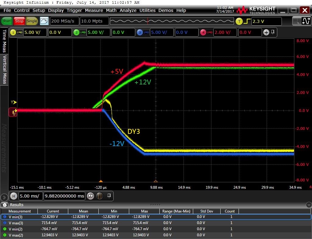

My customer use GD75232 of their RS232 port ,they feedback an issue that system can't detect their interface board with GD75232 and find  the waveform of DY3(pin8 DTR)  as attached , please help to check does it normal.

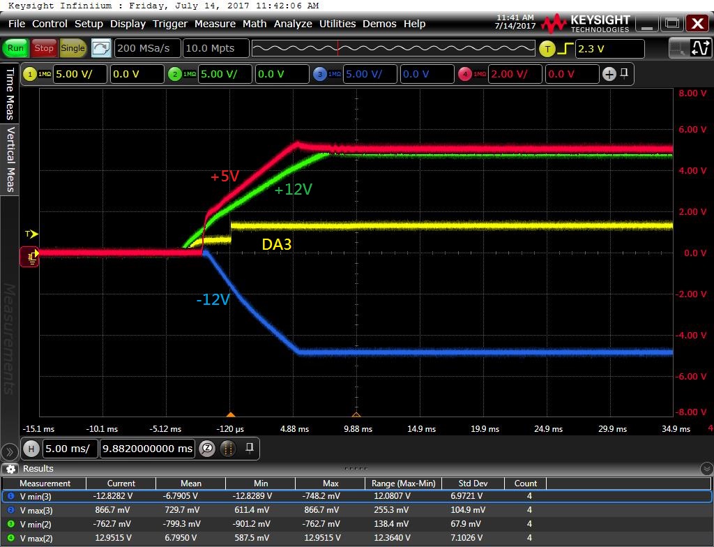

    The waveform was captured during system power on and no device connect to RS232 port (GD75232 output).
    Yes, my client's question is DY3 signal ramp up during the transition such as following red circle.
     ,does it normal.

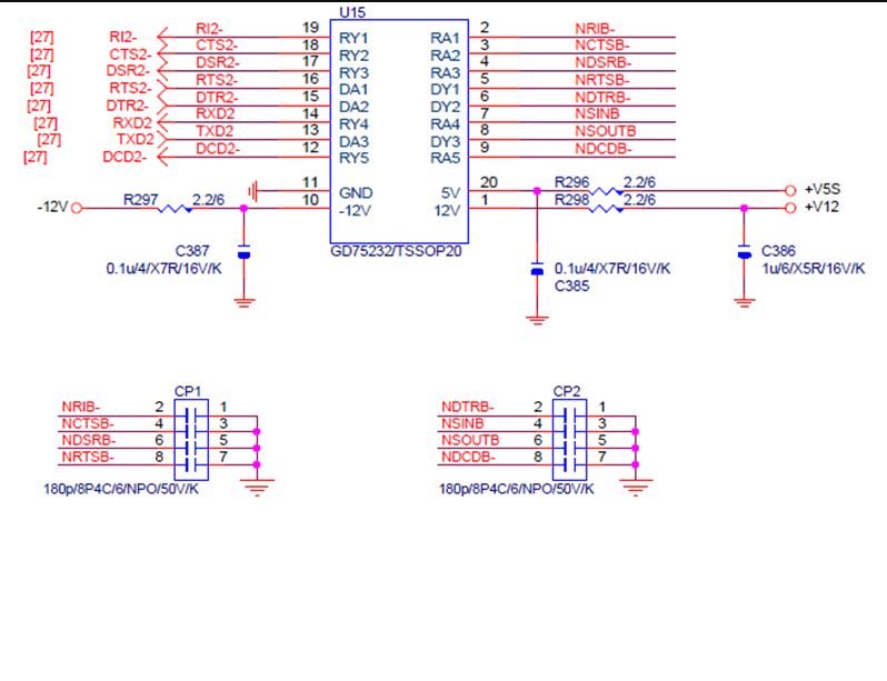

    Can you give some information about power supply, DA3 and DY3?
    =>Please refer schematic as below.

    Do they have pull up / pull down resistors?
    =>there is no pull up / pull down resistors, please refer schematic.

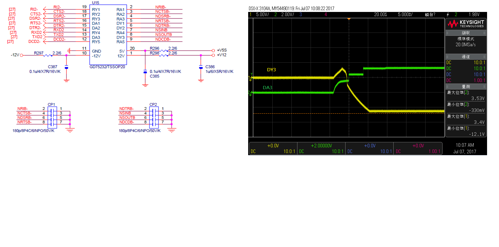

    Thanks for the screen captures. I just have one more question. What's the voltage level when DA3 is settled? If the pin was left floating, it would stay around 1.4V and DY3 would go high. I would like to understand what pulled up DA3 pin. Thanks,
    Hao
  • Hi Hao
    DA3 connect to SI/O and internal pull high 3.3V
  • Alex,
    Considering the setup, the DA3 and DY3 responses make sense to me. When Vdd begins to ramp up, the state of internal circuitry is undetermined. As Vdd reaches a certain voltage level, all signals should behave like normal function. Therefore you see DY3 follows Vdd before responses to DA3 input. In lab test, I got similar results.
    BTW, a specific power sequence is required in the datasheet (Note 4 on page 4). Ideally we want a power supply settles before another one starts ramping. When all power supplies ramp up/down at same time, even with some small delay among the timing, the device's behavior is hard to predict, which would depend on the relative potential and timing among the supplies. Please let me know if you have any questions.
