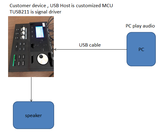

      Customer used TUSB211 chip in our new product to drive the USB audio( using a USB cable to connect computer or laptop , then playing wav or MP3 audio in PC and listen the sounds in our product). We found there are some click/pop sounds when playing the wav or MP3 .

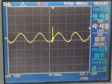

         I used 440Hz sin wav to test and took a photo from oscilloscope as below
         We found the click/pop sounds was caused by receiving wrong data from computer. If reduce the cable length(For example, 0.8m), the click/pop sounds might disappear.

                    Please clarify what kind of communication you are transmitting. The TUSB211 works only with USB2 signals, specifically with High-speed (480Mbps), and the glitch that you observe seems to be the connection detection from our device. Please let me know whether the device is being enumerated in HS.

        The signal on the scope capture does not seem to be HS, please use an utility like the USB tree View to verify the speed connection on the device. Also, let me know the Host and Device that you are using. It shouldn't be any audio glitch when transferring the data packets.  Is it a bulk transfer or an Isochronous transfer?

  • The diagram is as follow.

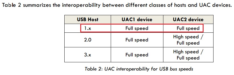

    2. We used USB audio class 1.0 in FS.  Please see summarize as below

     2. We used USB audio class 1.0 in FS for USB audio. Please see the summarize as below:

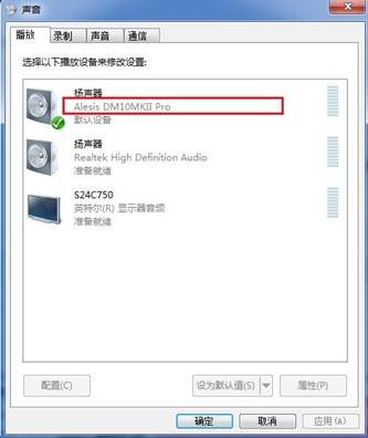

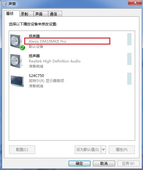

     4.  When the computer connected the product via USB cable successfully, the USB audio device"Alesis DM10MKII Pro" will display.

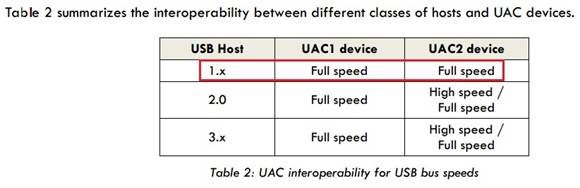

    2、We used USB audio class 1.0 for transfer. Please refer to the summarize as below:

    4、When the computer connected the our product successfully, the "Alesis DM19MKII Pro" will display in speaker menu as below.

    The point 2 confirms that the connection is not High speed, but Full speed. Therefore the TUSB211 is not active and explains the glitches on the signal (connection detection). You can have a device version 2.0 (High speed) but with Full speed connection.
