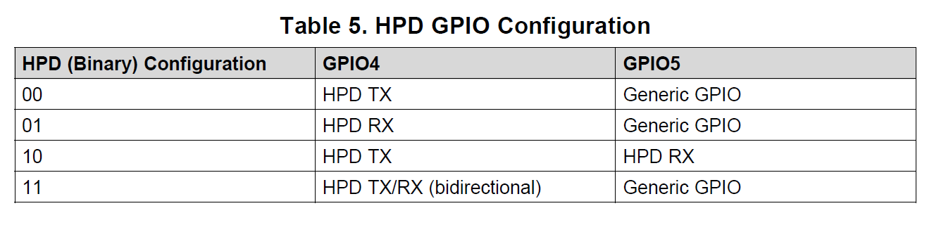

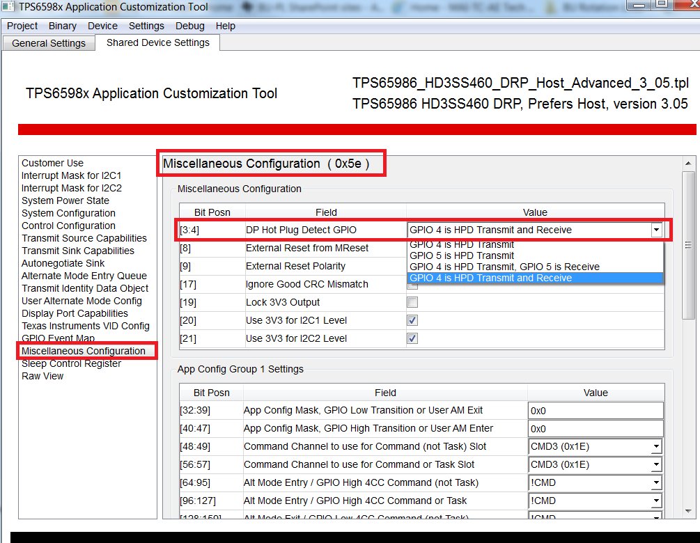

May I know which register can config GPIO4 or GPIO5
And which register can check HPD status and HPD IRQ status ?
  • Hi Kai,
    You can configure HPD in the Application Customization Tool under Miscellaneous Configuration(0x5e). The specific bit position are [3:4]. You can monitor GPIO4 or GPIO5 by using the Host Interface Tool read back the GPIO Status(0x72).
