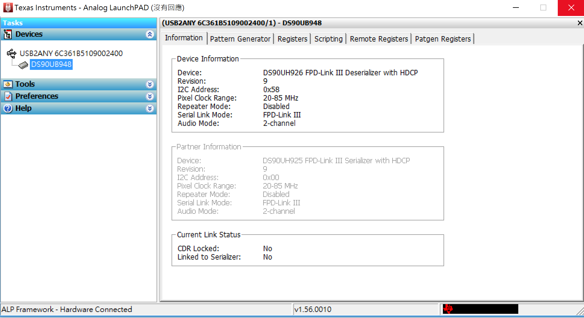

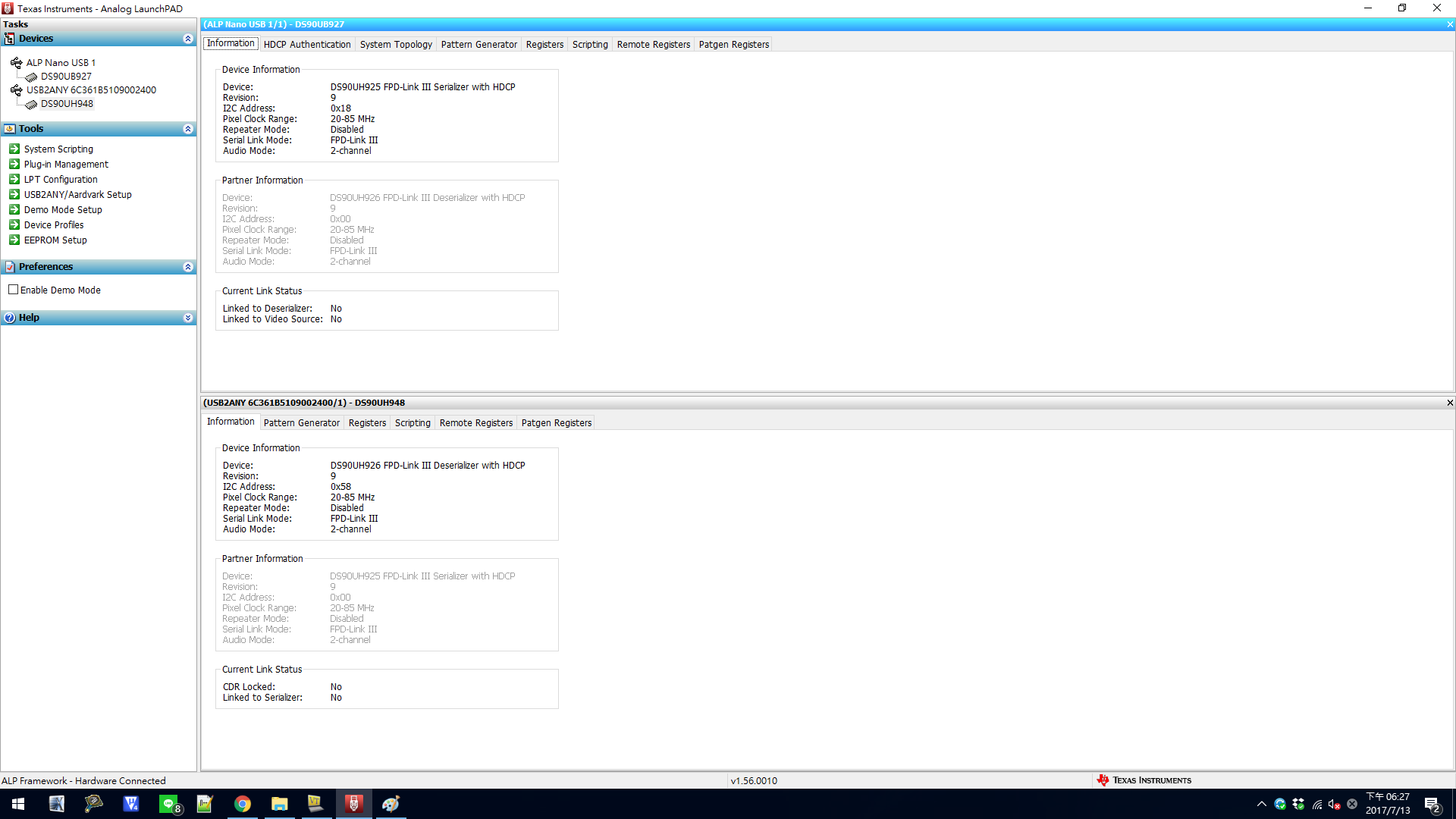

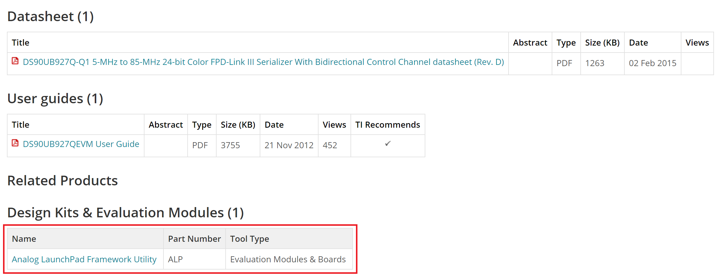

We're Trying DS90UB927Q-Q1 Evaluation Board To Connect DS90UB948-Q1 Evaluation Board And Meet Into Some Problems. First We Downloaded The Utility: Analog LaunchPad Framework Utility And Find The Utility Can Not Execute 2 Versions For Which Mentioned DS90UB927Q-Q1 And DS90UB948-Q1 Evaluation Board At Same Time. And The DS90UB927Q-Q1 Use Older Version And The USB Driver Can Not Be Identified. Even Install The Driver Manually From The File Path Connection To HOST PC Remain Failed. So We Can Not Go On Our Test. Please See Your Website And Try Yourselves:
The ALP Version For DS90UB927Q-Q1 Is 1.55.0010
And For DS90UB948-Q1 Is Same With 927Q-Q1
In Fact They're Different
We Downloaded ALP Of DS90UB948-Q1 From Utility Page And Got Filename:SNLC048B
We Either Downloaded ALP Of DS90UB927Q-Q1 From Utility Page And Got Filename:SNLC045C
And We Tried Both Of Versions For DS90UB948-Q1EVM. The Driver Works Well!

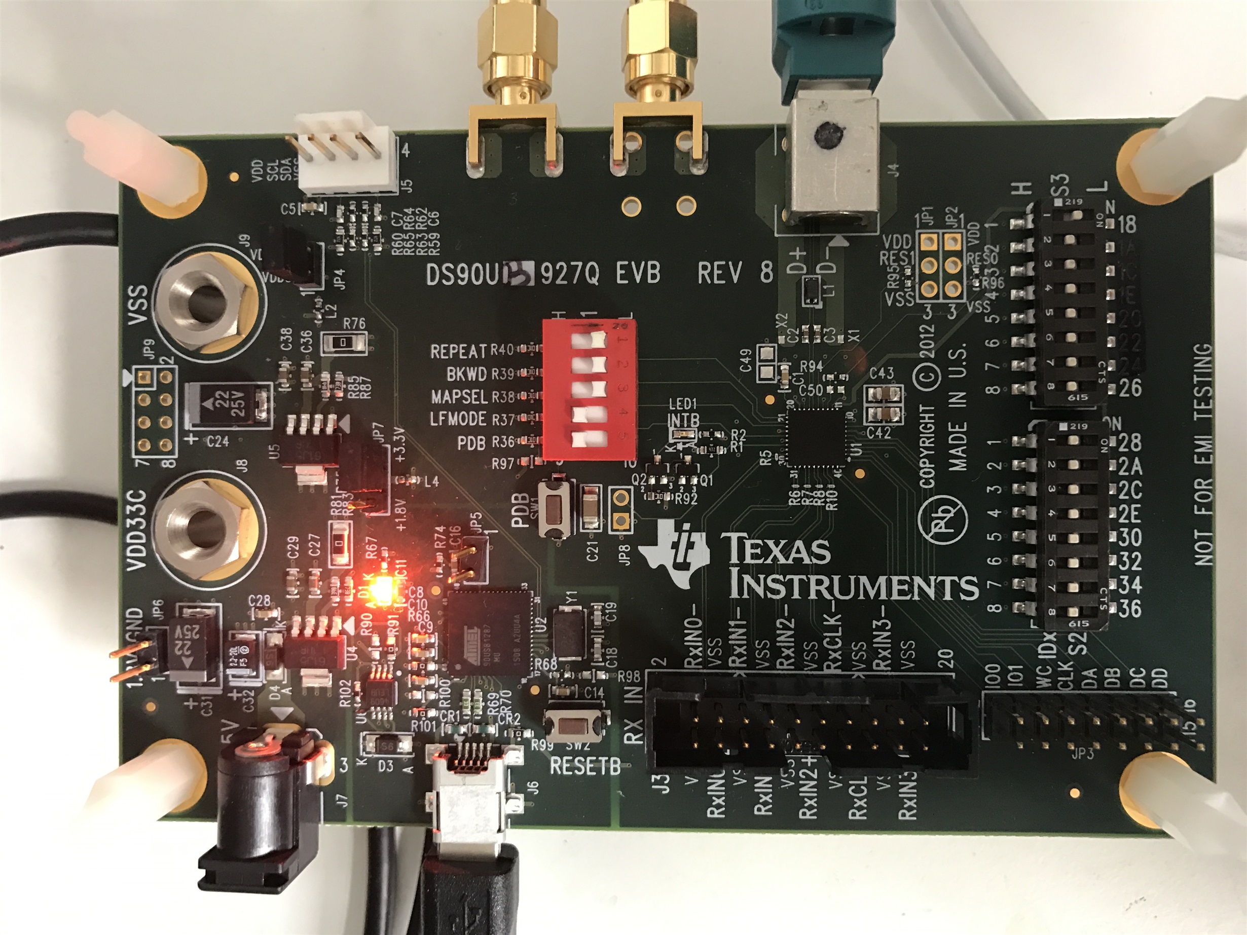

We Tried Both Of Versions For DS90UB927QEVM. The Driver Doesn't Work!!!
Can You Provide A Correct Driver For Win 10? We Find Your Evaluation Board Use Cypress's USB Chipset But After Downloading The Driver From Cypress Your Board Still Doesn't Connect With Host PC.
