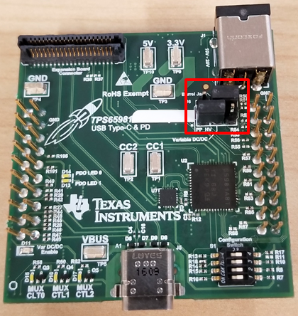

I wanted to setup a DP Alternate Mode demo with the 2x TPS65981 + DP-EXPANSION-EVM. Unfortunately – you know Murphy’s Law for sure – the demo did not work…
When I prepared the demo, I was not able to re-flash the memory.
- Connecting to the EVM via FTDI interface works
- Selecting and loading an application profile – Yes
- Erasing memory 100% > successful
- Flashing memory 100% > successful
- Flash verification goes to 100% but shows FAILED!
Using the recovery / fallback image also brings the same results.
One board showed this behavior directly after unboxing, the other one after ~1 hour debugging / trying to get it working.
I hope that I did not destroy the board.
> Do you have ideas how I could get the boards working?
