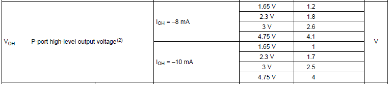

TCA9535: Is there VOH min value under VCC=1.8V?
Guru 29720 points
Part Number: TCA9535
Hi Team,
My customer considers to use the device under VCC=1.8V
Yaita / Japan disty
  • Hello Yaita-san,
    The values will be slightly higher compared to the VCC = 1.65 V specs. You can get an idea for the difference in level between VCC = 1.65 V and VCC = 1.8 V as well as the effects of output current and operating temperature by looking at Figures 11 and 12 in the datasheet. Please let me know if you have any other questions.
