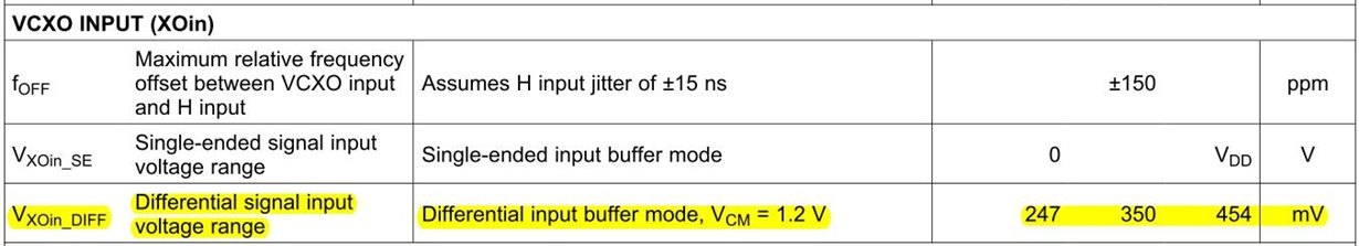

Hi Team,
Please allow me to clarify whether if you could use below TCXO.
Our customer is planning to use TCXO which has 800mVp-p single ended output. I believe you could use it by applying 0.4V to XOIN- pin regarding below specification.
My understanding is that if you have differential voltage of +/-247mV, device could recognize low and high signal. Is my recognition correct ?
Kawai
  • The levels are OK, but TCXO with clipped-sinewave output is not recommended because of the slow slew rate will degrade jitter performance.  The Vxoin_diff spec is assuming a faster slew rate (differential LVDS), and not a slow single-ended signal.  If they use single-ended input mode, they should use a LVCMOS driver which will have faster slew rate than sinewave or clipped sinewave.
    Alan
  • Hi Alan-san,
    Thanks for your advice. We internally discussed and came up to the same opinion. We are asking customer to choose LVDS or LVCMOS output TCXO.
