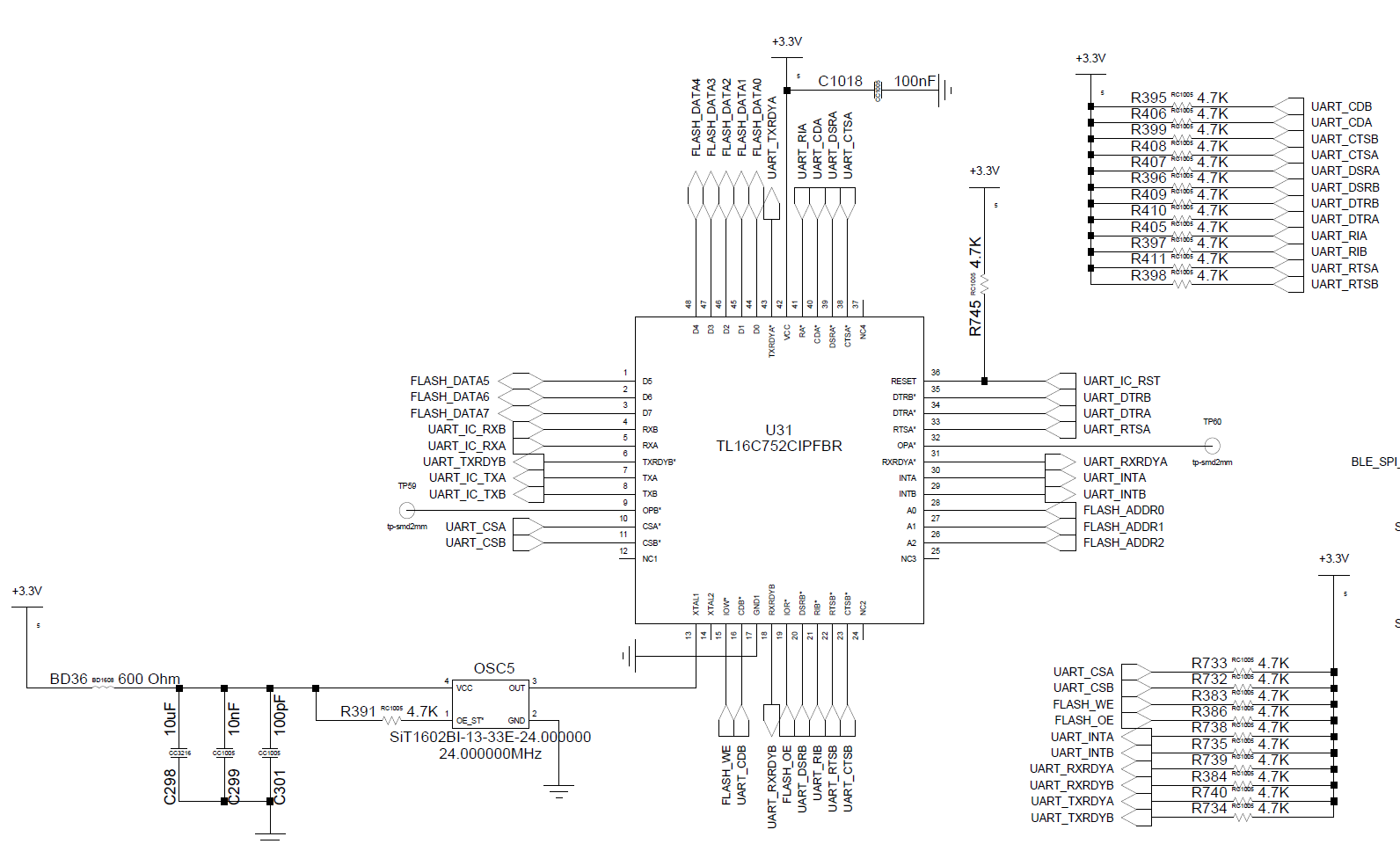

The internal register of TL16C752C can read but not write.
In the datasheet, LCR seems to be able to read and write without restriction, but it can not be written.
Signal timing is more marginal than requirements.
Please check if there are any issues to consider when writing, and please check if there are any problems in the circuit below.
thanks,
TS
  • Hello TS Yang
    I can see that you have a problem with the reset connection. Reset is active high, and you have this pin tied to vcc trough 4.7 K resistor. I recommend you disconnect this resistor and connect like pull down. With this one you can ensure that you device is not in reset state.
    You can take a look into our power supply recommendations, in that one we recommend to use extra capacitors as close as possible of Vcc pin of UART.
    Before you start to work with the device, I recommend you to apply a reset and then, read register LCR and LSR (the values that they have to have are 1D and 60).
    Please, do these changes and let me know your results.
    Francisco
  • Hello Francisco,
    Reset was overlooked because Active low is common.
    We confirmed that it works normally after setting it to Active High.
    It is unusual for the Read to be performed even when the reset is applied.
    Thank you for your help.
    TS
