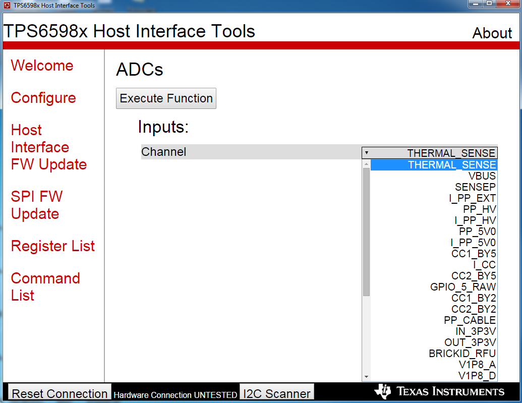

We suppose to monitor the current flow from the USB-C connector using the TPS65981 internal ADC. However, we see simply channel selection and read-out register bits on TRM. I'm not sure on the channel selection register bits value intended to select the PP_HV. Could you please provide us with ADCChan register bit description on selecting which input to be sensed? Also, the TPS6598x Application Customizer GUI has no such relative information on ADC read-out. Please support us with necessary documents.
Inline image 1
Inline image 2
Also, we like to explore the TPS65981 programming through SWD interface. Please suggest us with the appropriate Debugger kit if any and provide us with user manuals to get started with the same.
Manikandan M V
  • Hi Manikandan,
    You can use the internal ADC to read the SINK current on PP_HV using the TPS6598x Utilities GUI by using the ADCs command in the Command List tab. The ADCs channels are listed there with "Thermal_Sense" as channel 0. The channel for I_PP_HV would be channel 5.
