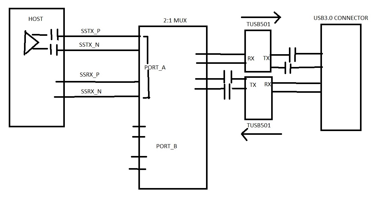

I have an Host with USB3.0 port. The host implement AC coupling capacitor in the SSTX pair output. In my board i have a 2:1 mux and two TUSB501 one for the SSTX pair and one for SSRX pair.
I placed AC capacitor like in the attached picture. Is it correct? Thanks
  • Hi Nicola,
    If the 2:1 mux is a passive switch, the AC capacitors placement is correct, the other device connected in PORT_B will have it's Tx capacitors too.
    If the 2:1 mux is an active switch, you would need to add capacitors on Tx port of the switch.
