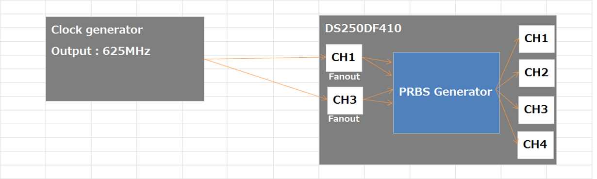

3) The customer would like to use the PBRS generator as the following block.  Does it have problem?
    •  Thart setup should be fine
