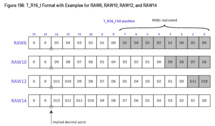

I'm using the below patgen script with the 964.
According to the datasheets, the default colors for the 8-bar script should be:
 ['AA' '33' 'F0' '7F' '55' 'CC' '0F' '80']
 However, the stream that I’m getting in is:
 ['AA2A' 'CC0C' '3F3C' 'DD1F' '5515' '3333' 'C003' '2220']
 Reordering it as little-endian, followed by the nVidia  bitmasking the first/last 2 bits, and bitshift >> 2:
['AAA' '333' 'F0F' '7F7' '555' 'CCC' 'F0' '808']
As you can see, it appears that one of the words appear to repeat for each pixel.
  • FO --> FOF
  • 0F --> 0F0
Is this expected of 8-bit registers filling a RAW12 frame, or am I facing an upstream error?
Resolution, filesizes otherwise look ok to me.

  • Michael,
    After further investigation, we concluded that the behavior is expected operation.  When using the color bar pattern, it sends a repeating sequence of bytes, designed to test the byte interface for CSI.  When translated to 12-bit data, the repeating pattern may not be a constant 12-bit pattern.
    For example, 0xAA_AA_AA does translate to two pixels of [0xAAA, 0xAAA] based on CSI-2 RAW12 assignments.
    On the other hand, 0xF0_F0_F0 translates to [0xF00, 0xF0F]
    0x0F_0F_0F translates to [0x0FF, 0x0F0]
    If desired, a constant value could be programmed on each color by ensuring the 8-bit value uses a repeated 4-bit value (i.e. replace 0x0F, 0x7F, 0xF0, 0x80 with something like 0xFF, 0x77, 0x00, 0x88).
    As an alternative, the pattern generator can send a "fixed" pattern with only 2 color bars, a color and it's inverse.  In this mode, you can program a 24-bit value into the color registers that will be repeated, providing a constant 12-bit color after RAW12 conversion.
