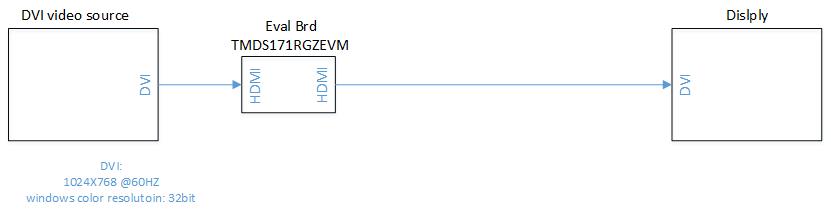

1. How are the 150-300 ohm TX TERMINATION connected? Two pull up's or single resistor for each lane? is it possible to get simplified termination-resistors connection?
2. The definition of the TX_TERM_CTL pin #36 of the TMDS171 is different in the data sheet and in the evaluation board TMDS171RGZEVM. Which is the right one?
3. If jumper J14 at the evaluation board TMDS171RGZEVM is at the low pins (short 2-3) and the data rate is about 0.5G, what is the schematic of TX TERMINAL RESISTORS?

  • Hi Moises
    As when the EVAL BRD, when placed between our video source and the display solves the original problem of picture quality, we want to place the IC TMDS171 in our RFI card.
    However, the picture is ok only when J14 in the evaluation board is down (2-3); other settings like swing don't affect the quality.
    Also when tried by s/w, the change in TX TERM to 150-300 ohm  cause picture to be OK. Other s/w parameters like swing, emp, eq did not change the visual display quality. ONLY TX TERM.
    Please: what is the change in the EVL BRD behavour when J14 is down or when s/w set to 150-300 ohm.
    Thanks.
  • Hi Ofek,
    So it appears that your system will only work if the source (TMDS171 Transmitter) has terminations enabled. The 150-300 ohm terminations can be enabled by the TMDS171 register or setting J14 low enables the 75-150 ohm terminations (which are only valid for HDMI 2.0). Enabling the terminations will have the effect of lowering the average DC level of single-ended signals. What level is your display expecting? Have you tried increasing the Vsadj resistor?
