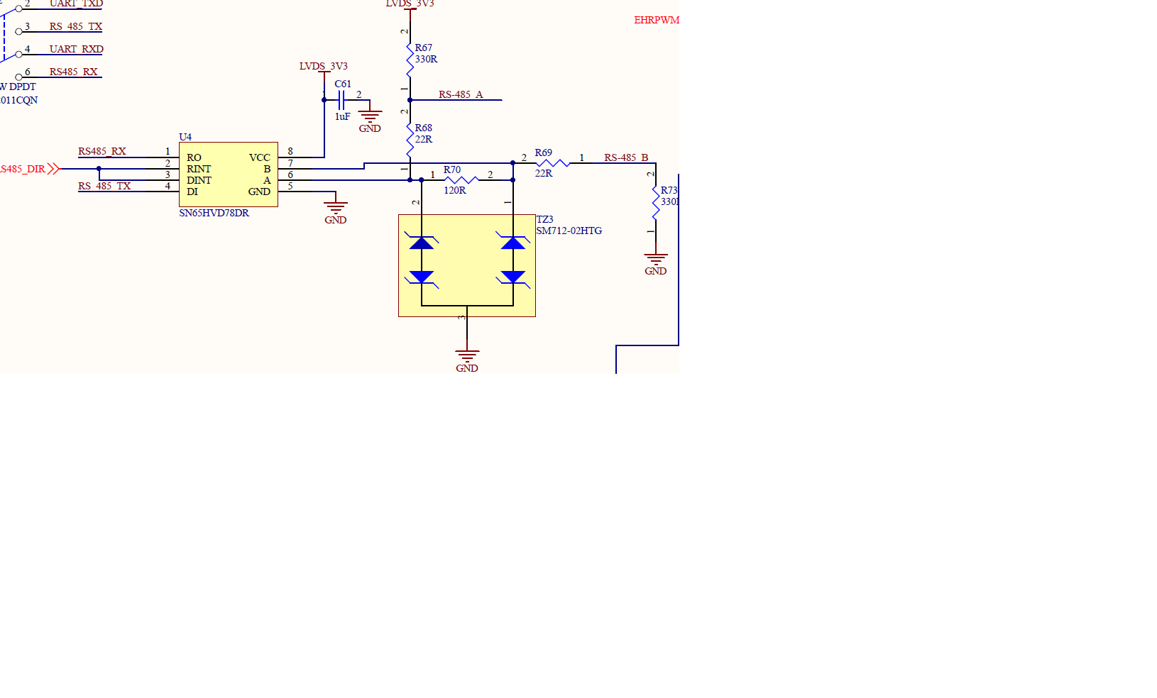

I am designing a custom board and i have a requirement of RS485 Transceiver IC for data communication
So i have selected SN65HVD78DR IC
I have also attached my circuit .
I have following few questions as i have not worked much on RS485
1)What is the co relation between A, B Differential Signals with + & -ve Differential signals. I have gone through many links and in which few suggests that A is considered as  -ve signal and B is considered as +ve signal .But in few reference designs it was routed in the opposite way . Please relate me these terminologies to avoid
2) The differential voltage level for the bus that i used here is 3.3V .What if the other connected RS485 device differential voltage levels is different (say 5V/10V) .Will the communication happens? and if so at what v/g level?

  • Hello Chandan,
    The convention that all TI parts use for the AB lines is that A is +ve and B is -ve. As for the differential signaling, it will not matter if you are using a 3.3 V part in conjunction with other voltages. RS-485 only looks for a differential signal of ± 200 mV. The RS-485 spec for input voltages is -7 V to +12 V. Any voltage within that range will work.
