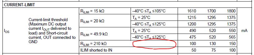

We got a question from customer about TPS2553-Q1.
Could you help us?
[Question]
Our customer is considering Rlim=210k. In the datasheet, the current limit is defined at Rlim=210k. But the temparature condition is doesn't clear. What is the temparature condition at Rlim=210k? Is it "Ta=-40 to 125C"?
tateo
