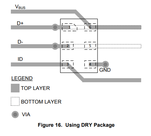

I am working on a design with the TPD4S012DRYR for USB ESD protection. The datasheet recommends the layout of the 6 pin DRY package be like:
However, this seems to be tough to layout without creating stubs as USB connector pin out is:
1. VBUS
2. D-
3. D+
4. ID
5. GND
I need to switch layers with through hole vias on the PCB to make sure the tracks flow nice and straight without the possibility of creating a stub.
My question is: Can I connect D- pin from the USB connector to D+ pin on the TPD4S012DRYR as internally I assume they both have exactly the same diode structure?
