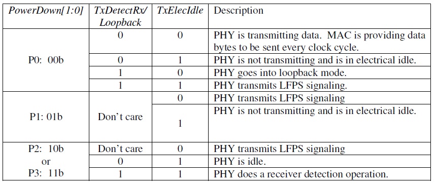

This problem is that TUSB1310A does not output CP1 even if ping LFPS is received
while it outputs CP0 in compliance mode.
My customer wants to know any setting required for Compliance pattern sequence.
Please let me know.
By the way, as to RX_ELECIDLE there are below 2 descriptions in the datasheet.
I think that the "RX_ELECIDLE" of 5.3.4.1 USB Power Management is a typo and
"TX_ELECIDLE" is correct.  Is this correct?  Please let me know.
・Table 3-3: RX_ELECIDLE :
   Active High. While deasserted with the PHY in P0, P1, P2, or P3, indicates detection of LFPS.
・5.3.4.1 USB Power Management:
 "When RX_ELECIDLE is deasserted in P0, P1, P2, or P3, the TUSB1310A device receiver monitors for
  LFPS except during reset or when RX_TERMINATION is removed for electrical idle."
