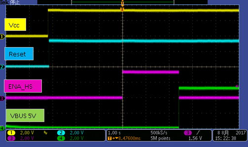

The ENA_HS pin is asserted after three secs from Vcc starts up as follows on customer's circuit.
Is this behavior correct?

Hello Kuramochi-san,
ENA_HS indicates that there is HS activity (480Mbps) in the differential pair, I don't see any issue here.

Diego-san,
Sorry for uncertainly.
Follows are information of waveforms.
Yellow: D-
Blue: D+
Green: VBUS_5V
I would like to know why ENA_HS rises up without D± signal.
