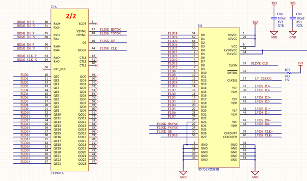

we need to convert HDMI to drive a LVDS panel (see attached datasheets of both display and controller
We are using the TFP401A together with the SN75LVDS83B. Please see the schematic below to see how we connected the two ICs.
Questions:
1) About connectivity between the two TI chips. According to the attached TI app notes and datasheets there are a number of different ways to connect the two TI chips to each other. It looks like that depends on the display driving pattern. But we could not make much sense. In our schematic you can see how we connected them together but we don’t think the way we connected them is correct because the data from a supplier shows a different configuration (but we only have partial information on that). So could you please show/let me know the correct connectivity to drive the attached display in both 6 bit and also in 8 bit configuration of the display.
2) Following from the above question, could you please explain more clearly the logic behind the connection between the two TI chips? Could you please explain it in detail.

    we have now made a board as per your guidelines above (we use a 8-bit display config) but there is no video signal.
    Could you please check the attached schematic especially:
    1. the connection between the TFP401A and the SN75LVDS83B
    2. the configuration of both of the above ICs
    3. the connections as mentioned in point 1 above considering the IC datasheet of the display we are using (attached PDF)
    Many thanks
    Rick

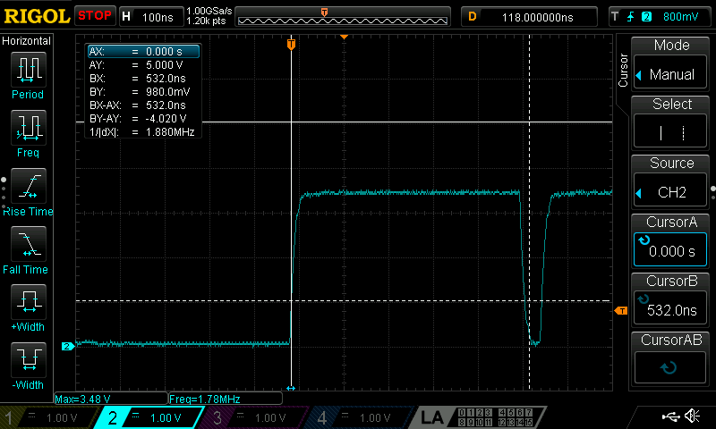

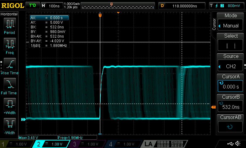

  • Hi Joel,
    VSYNC is a steady 0V
    HSYNC is a steady 3V3
    DE  is a steady 3V3
    ODCK please see the two attached scope screenshots (one freeze frame and one running). The one showing a running trace shows a lot of jitter. The frequency seems around 1.8MHz BUT (!!) the scope we have is only 1GSps - 100MHz so if the clock is a lot higher the jitter in the screenshot might be due to the scope limitation in the waveform acquisition.

  • Hello Rick,
    The TFP401 looks configured correctly in the schematics. It seems that your hdmi source is not sendding data to the TFP401. With no input, the device will output the free-running PLL on ODCK. With no input, the state of the control and data output signals is unknown.
    Keep in mind that the TFP401 is not involved in the EDID communication, the EDID information will flow directly from the Display to the graphics controller through the DDC lines. If you HDMI source needs to know the EDID information to start the video transmission you need to have an EDID ROM to store the display information, this is for example how the PC knows the capabilities of the sink.
