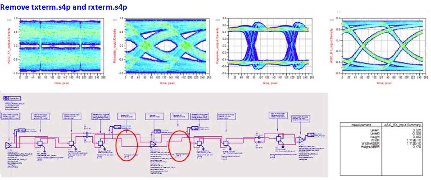

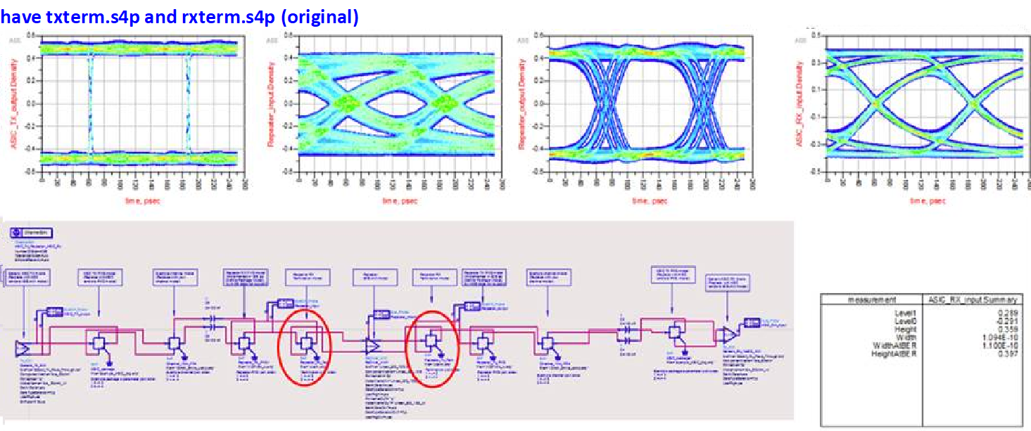

May I know what's transmitter termination and receiver termination's mean ,is it mean RLGC termination circuit ?
I can't make sure our simulation is right ,could you provide a example to me?

Hi Kai,
The termination models are included to represent the termination resistance found in the Rx and Tx circuits. Without the termination impedance, the reflections from the input only are much larger. Without the termination attached the receiver is a high impedance circuit.
Lee
