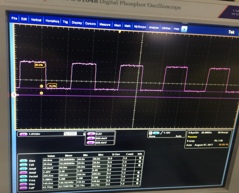

TCA9617B shows that Volb is about 0.5V. Is there any document that shows the reason? Thanks!

I will summarize why there is a "static voltage offset".
First, I want to let you know that the SCL and SDA have identical circuitry.
Second, I want you to note that this is a bidirectional protocol, where the low can be generated by either the Master or the Slave.
Lets take an example.
You might ask, why does the SCL need to have this feature. Generally speaking the SCL is created by the Master. That is not always true. If the Slave does clock stretching then it needs to be able to pull the SCL low. Therefore that circuitry is needed there too. Also, if you have a multi-master I2C tree it would be needed there too.
I hope that helps. Let me know if it is still confusing.
