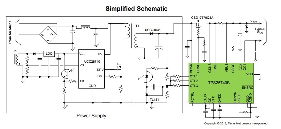

  • Hi Ikon,
    If you are only interested in USB Power Delivery then the TPS25740B can perform that job without the need for serial flash chip config. The TPS25740B DFP PD controller that uses a resistive divider circuitry to implement the default voltage setting of 5V,9V,15V,20V or adjusted for 5V,9V,12V,15V.
    For more information, please take a look at the following:
    Datasheet: http://www.ti.com/lit/ds/symlink/tps25740b.pdf
    Jimmy Hua
  • Hi Jimmy,
    Yes. They need something similar but this chip is for power source side. Portable speaker is on power ‘sink’ side.
    Any other recommendation?
    Thanks.
  • Hi Ikon,
    Thanks for the clarification. With that said, I don't think there are any other products that I am aware of that implements simple state machine process for a USB PD UFP application.
    If you are interested in making a power source then the TPS25740B would be a good choice. Otherwise for power sink, I would also agree with Eric that the TPS65981 would be able to satisfy your intended application.
