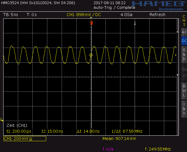

I have encountered a problem while debugging my TUSB1310A design. First of all I wanted to measure the PCLK. For that reason, I have booted up the system and then the PCLK was 250 MHz. But against to your documentation, the clock was 900 mV  /- 100 mV. Could this be correct? In the documentation I found, that the clock should meet the LVCMOS18 standard. Do you know, where the problem is?

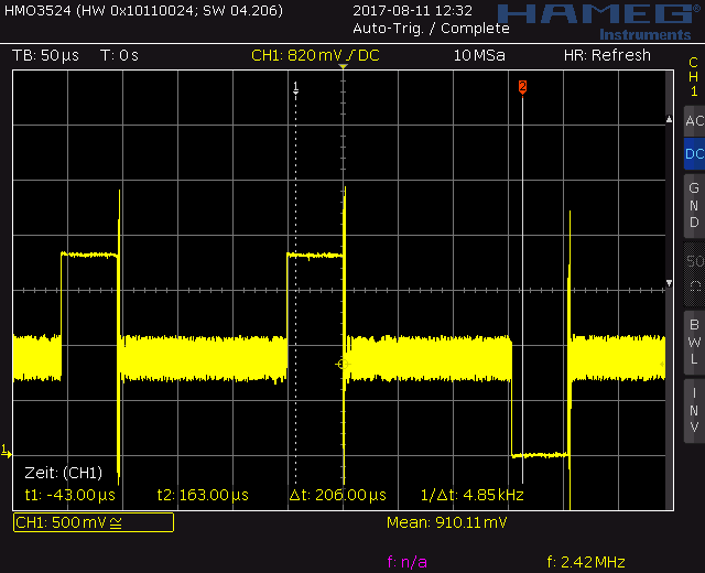

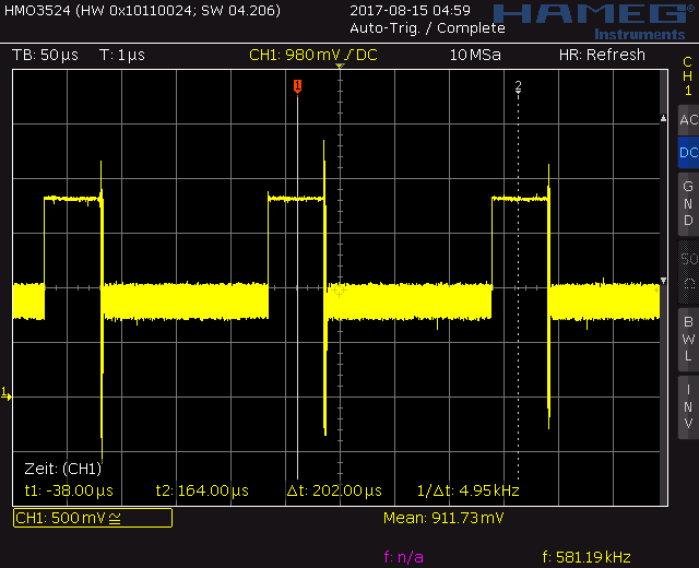

After a few minutes, the PCLK was getting unstable in the follwing way: The clock is “stable” for 150 µs as described at first (250 MHz, 900 mV  /- 100 mV), than it is high (1.8V) for 50 µs. This is periodically. So the “stable” part for 150 µs follows the high part for 50 µs and so on:

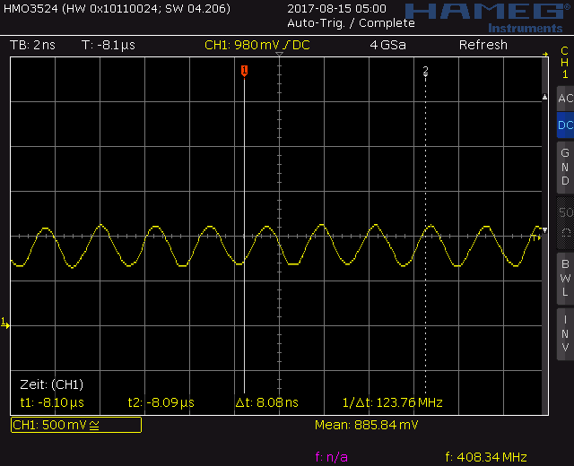

    SSC_DIS was low. I set it to high (pull up) and got exactly the same behavior:

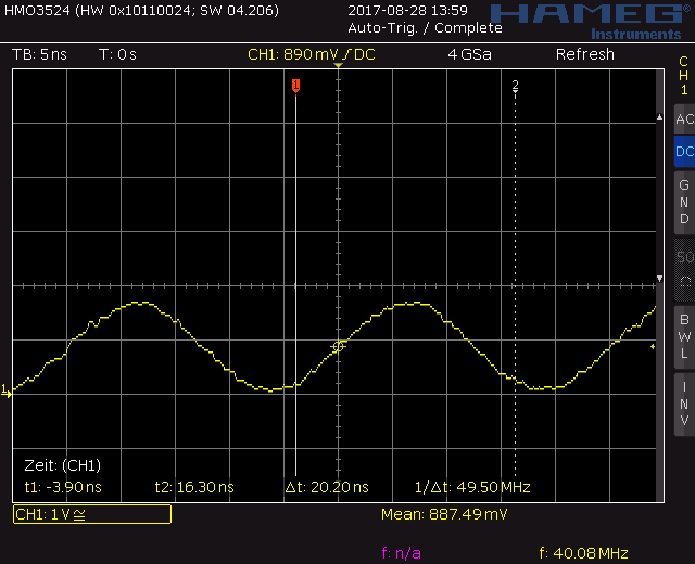

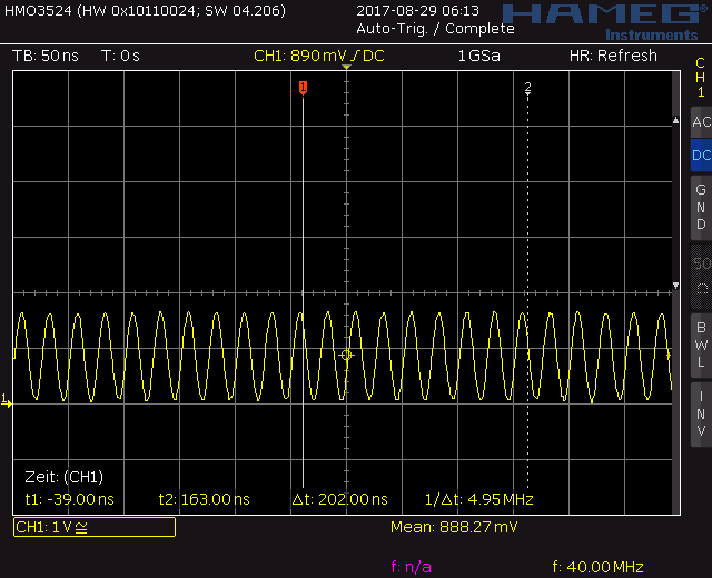

    I am not able to change the crystal on the board. But I do not think, that the problem is here because I am able to measure the 40 MHz clock of the crystal.

    Also, the scope capture says "40.08MHz", however, if I look at the cursors and the time delta the frequency would be 25MHz, can you double check that and make sure the frequency matches the REFCLKSEL[1:0] configuration?

    The scope says 40.08 MHz because the time I have captured was not enough to calculate the right frequency. The clock is 40.00 MHz. REFCLKSEL pins have pull-ups. Please refer to the schematic attached at the beginning of the thread.
