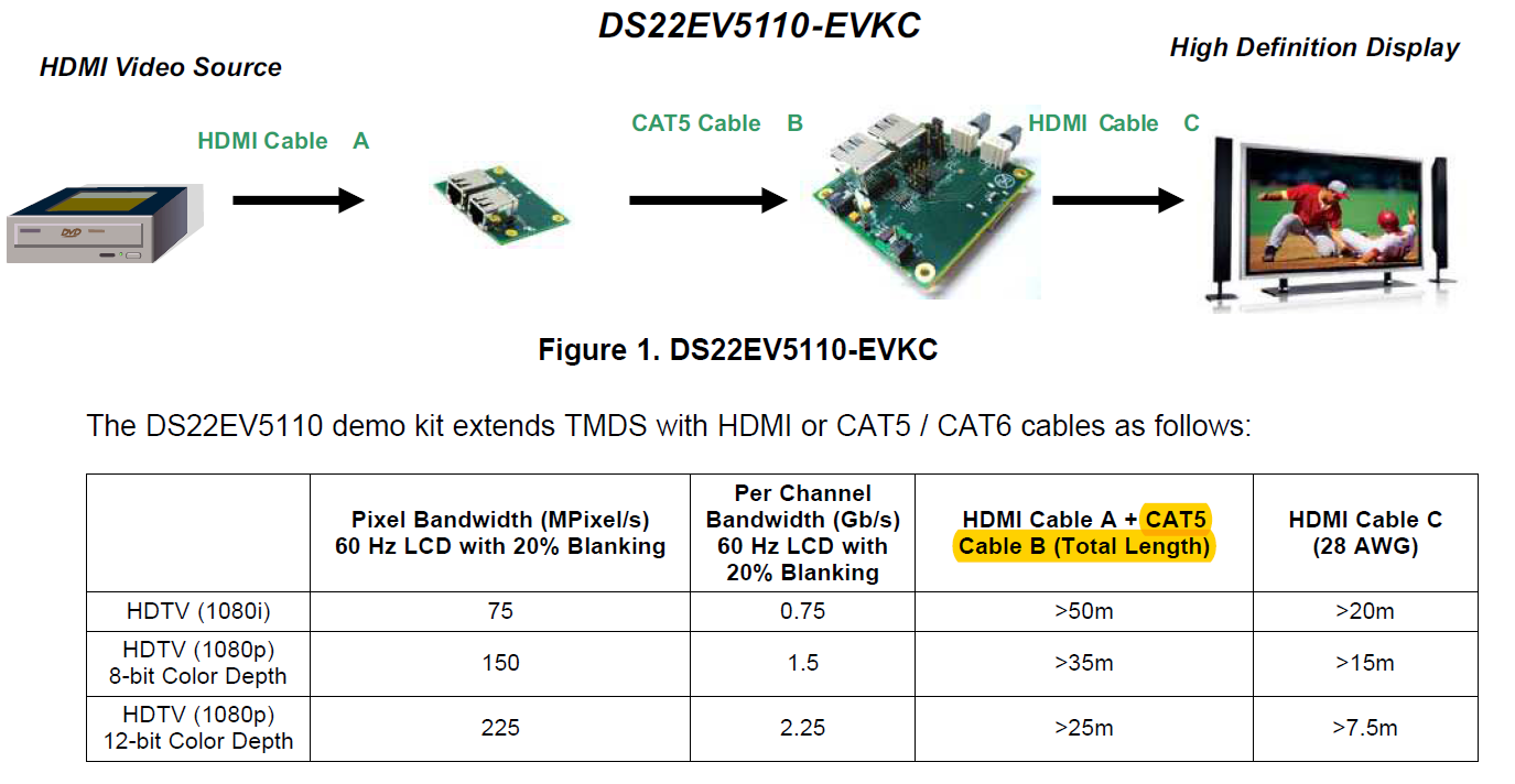

Does TI have RJ45 connector EVM for TMDS181 or TMDS171?
Our customer would like to know if use CAT5 cable ,how long can TMDS181 or TMDS171 support , do you have any test data?
