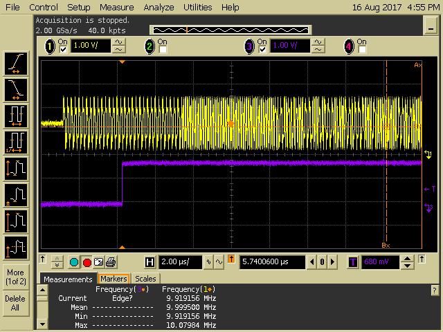

We are having troubles bringing up our new design with a DP83867IR installed.  When linked at 10BaseT the outgoing packet looks nothing likes an Ethernet frame.  We can see the TXEN from the RGMII interface go active indicating the MAC has something to transmit but the outgoing MDI transmit doesn't appear to be a valid Ethernet frame. See attached included picture.
Zoomed into an smaller area shows the following.
Not quite sure how to describe this as seen on the MDI interface but almost looks like a much shortened PREAMBLE with an end of frame indication.  As you can see in the previous image there are several with the time that RGMII TXEN is active.
We have verified the RGMII timing is what's expected.  Our routes are matched consequently we've strapped the RX and TX RGMII clock to 2.0ns to meet timing.  After inspecting the registers the strapping reads correctly.

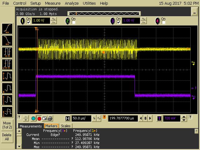

Below is a received packet on the MDI interface and the corresponding RGMII RXEN as expected.
I realize its a little hard to see but there is PREAMBLE, SFD along with packet data.

At this point we are at a loss as to what to look at next.  Any pointers?

    One thing to note here is that I don't quite understand why you have a link present. From your register dump, your DP83867 is set to auto-negotiate and it has a link in 1000M according to BMCR. But looking at the PHY status register, it says you have a 100M link.
    Checking out your auto-negotiation advertisement register, you're advertising no modes. Can you please set register 0x4 to indicate that the DP83867 supports 10M modes? A setting of 0x0050 in register 0x4 would be ideal.
    What is the frequency of the TX_CLK coming out of the MAC? That will indicate what speed the MAC thinks the link is running at.
  • Rob,
    Believe we found the issue. In our design we use the CLK_OUT pin to source the GTX125 reference clock back to the MAC. Like you mentioned CLK_OUT is a buffered version of the reference clock XI (25MHz). For our design we needed the PHY to output a 125MHz clock for the RGMII GTX125 reference clock. Once register IO_MUX_CFG (0x170) is set to 0x080D we were able to have communications from the MAC to the PHY and back again using ping. I would have expected the CLK_OUT pin to adjust according to the link rate. I.e. 1000BaseT CLK_OUT = 125MHZ, 100BaseT CLK_OUT = 25MHz and 10BaseT CLK_OUT = 10MHz. However that is not the case. With register IO_MUX_CFG set to 0x080D CLK_OUT is always 125MHz. What am I missing here?
    Thanks for your prompt response.
    -Gary
  • Gary,
    TX_CLK and RX_CLK have a variable frequency based on link speed as you noted.
    The 125 MHz out of the DP83867 is based on the line driver's transmit clock, for 10/100/1000 this is always 125 MHz.
    Usually a MAC that needs a 125 MHz reference, can handle it's reference clock being fixed at 125 MHz. This should work OK at 10 and 100 assuming your MAC is on FPGA IP.
    GTX_CLK and RX_CLK of RGMII are then derived from the 125MHz, typically.
