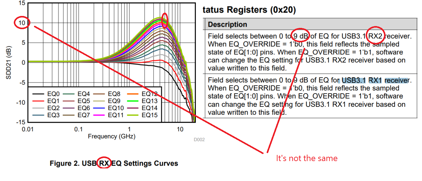

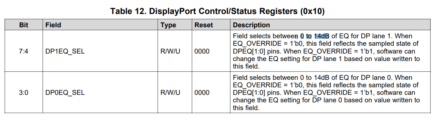

I read 0x10 register and result is 00110011
May I know the dB value ?? could you provide the mapping table ??
