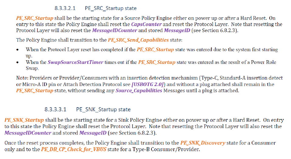

Can you confirm the PR_swap bug is still fixed in 4.43 ? as I still see various failures :
Events #443-444 PD Sequence Start (Power Role Swap)
Event #443 PD Message - PR_Swap (from UUT)
MessageID is not one greater than that previously sent. [PROT_MSG_HDR_6] F*
Event #444 PD Message - GoodCRC (from Tester) (SOP)
  • Hi Dominic,
    This PR_swap bug was fixed in 4.43 as per PD specs. After a PR swap, we shall reset the MessageID (see below) and should not continue to increment as per your failing case. What kind of compliance tester are you using and what is the TPS65983 connected to?
    Jaime

    Events #129-130 PD Sequence Start (Power Role Swap)
    Event #129 PD Message - PR_Swap (from UUT)
    Event #130 PD Message - GoodCRC (from Tester) (SOP)
    Events #131-134 PD Sequence Start (Soft Reset)
    Event #131 PD Message - Soft Reset (from Tester) (SOP)
    WARNING: This message was not expected in the current context.
    Event #132 PD Message - GoodCRC (from UUT) (SOP)
    Event #133 PD Message - Accept (from UUT) (SOP)
    Event #134 PD Message - GoodCRC (from Tester) (SOP)
    Events #135-136 PD Sequence Start (Announce Source Capabilities)
    Event #135 PD Message - Source Capabilities (from Tester)
    Event #136 PD Message - GoodCRC (from UUT) (SOP)
    Events #138-145 PD Sequence Start (Power Transition Request)
    Event #138 PD Message - Request (from UUT) (SOP)
    Event #140 PD Message - GoodCRC (from Tester) (SOP)
    Event #141 PD Message - Accept (from Tester) (SOP)
    Event #142 PD Message - GoodCRC (from UUT) (SOP)
    Event #144 PD Message - PS_RDY (from Tester) (SOP)
    Event #145 PD Message - GoodCRC (from UUT) (SOP)
    Events #148-151 PD Sequence Start (Power Role Swap)
    Event #148 PD Message - PR_Swap (from UUT)
    Event #149 PD Message - GoodCRC (from Tester) (SOP)
    Event #150 PD Message - Reject (from Tester) (SOP)
    Event #151 PD Message - GoodCRC (from UUT) (SOP)

    MessageID is not zero after a power role Swap. [PROT_MSG_HDR_3] FAIL

    MessageID is not one greater than that previously sent. [PROT_MSG_HDR_6] FAIL

    MessageID is not zero after a power role Swap. [PROT_MSG_HDR_3] F*
