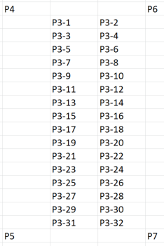

It is not clear on the EVM how the P1 and P3 headers are pinned out - Please provide guidance so that we can identify each pin on the Headers and associate that to the EVM schematic

Hi Steve,
From the schematic, BOM, and picture of the EVM from this document: http://www.ti.com/lit/ug/sllu013/sllu013.pdf
I believe P3 is pinned out like so:
And P1/P2 are pinned out like so:
I.K.
