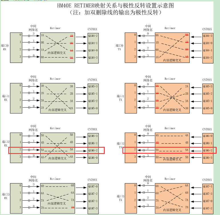

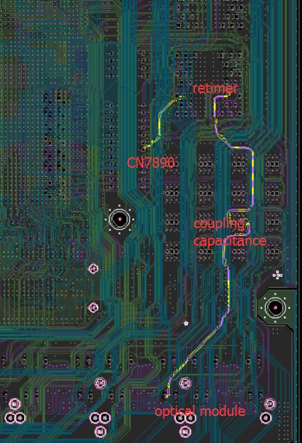

    reply     :   We are using 10G(XFI).
                      Optical Module(sfp+ rx): 10GRX-->(2235.32 mil)-->Coupling capacitor-->(1725.33 mil)--> (CH10 C RX)DS125DF160 ->(CH10 C TX)-->(939.21 mil)-->CN7890(Multi-Core CPU)
                      Optical Module(sfp+ tx): 10GTX-->(2158.23 mil)<--Coupling capacitor<--(2696.41 mil)<--(CH10 C TX)<--DS125DF160(CH10 C RX)<--(2952.65 mil)<--CN7890(Multi-Core CPU)
    • Question: Can the customner provide HEO and VEO readings (i.e. channel registers 0x27 and 0x28) for the channel in quetstion
                 reply        : REG[0x27] = 0x00
                                    REG[0x28] = 0x00
    3.Could we provide a reference setting for this device?
           To be able to provide a reference setting i would need more info on the application, such as basic block diagram and approximate insertion loss for both the rertimer input and output channels
            reply  :
                      Optical Module(SFP+ Rx): 10GRX-->(2235.32mil)-->Coupling capacitor-->(1725.33mil)--> (CH10 C RX)DS125DF160 ->(CH10 C TX)-->(939.21mil)-->CN7890(Multi-Core CPU)
                      Optical Module(SFP+ Tx): 10GTX-->(2158.23mil)<--Coupling capacitor<--(2696.41mil)<--(CH10 C TX)<--DS125DF160(CH10 C RX)<--(2952.65mil)<--CN7890(Multi-Core CPU)

  • Thank you for providing the details regarding the application. Below to recap are the high-speed ingress and egress data paths:
    • Ingress Path
      • Optical Module(sfp+ rx): 10GRX-->(2235.32 mil)-->Coupling capacitor-->(1725.33 mil)--> (CH10 C RX)DS125DF160 ->(CH10 C TX)-->(939.21 mil)-->CN7890(Multi-Core CPU)
    • Egress path
      • Optical Module(sfp+ tx): 10GTX-->(2158.23 mil)<--Coupling capacitor<--(2696.41 mil)<--(CH10 C TX)<--DS125DF160(CH10 C RX)<--(2952.65 mil)<--CN7890(Multi-Core CPU)
    My inputs are the following
    • The PCB channel between SFP+ module and the retimer is very short. The same is true for the channel between the CPU and the retimer. You may consider setting the retimer to adapt mode 0 and forcing CTLE value of 0 by adding the I2C channel register commands below to your configuration.
    REG
    Value
    Comment
    0x31
    0x00
    Set Adapt mode 0
    0x2D
    0x88
    Enable EQ override
    0x03
    0x00
    Set EQ = 00
    0x3A
    0x00
    Set EQ = 00
    0x0A
    0x1C
    Puts the CDR into RESET
    0x0A
    0x10
    Releases the CDR from reset
    • The SFP+ module already implements AC coupling caps on its inputs and outputs. Thus, you do not need to implenent additional external capacitors in between the SFP+ module electrical inputs and outputs and the TI retimer.
    • You mention that you are observing a content of 0x36 on register 0x2F instead of 0xB6 which is the value you believe are writing. 0x36 is the default value for this register. Thus if you are reading that value then you either did not execute the channel registe write correctly, or perhaps you implemented some type of reset operation, such as a channel registers reset via 0x00[2]
